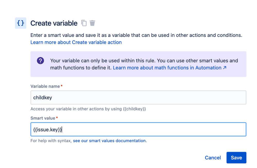

When the Child triggers your automation you could create a variable and populate it with the smart value for issue key and then use that variable in the comment.
Here's a screenshot of creating the variable:
Note: my assumption is that you are getting to the parent through a branch, you will want to ensure you create this variable after the trigger but before the branch or you will populate your variable with the Issue Key of your parent issue instead of the child.
