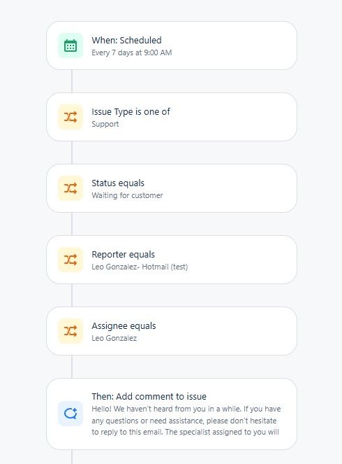

I'm trying to set up an automation where Jira sends the customer a comment. This is what it looks like:
When I run the rule it says no action performed. Yesterday the rule ran successfully. Let me know if you see I input anything that would cause the rule to not perform.

A few possible causes for the rule not performing any actions are:
  • no issues matched the conditions you show in the rule
  • no issues matched the JQL for the trigger
  • in the trigger, the option below is enabled, and because issues have not changed since the last scheduled run they were not processed
    • Only include issues that have changed since the last time this rule executed

Also check the comment component, by default the "Prevent duplicates by only adding this comment once to a particular issue." option is selected which would explain why it worked yesterday but not today.

Please post an image of your rule trigger, showing the JQL and option for including issues that have changed since the last time the rule executed.

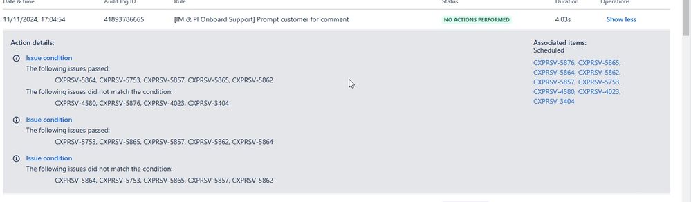

Based upon the log image you show, the third condition prevented any issues from proceeding: they did not have you as the reporter.
I suggest changing the trigger's JQL as that could test for all of the conditions at one time.  That is, add these and then test the JQL outside of the rule:
 AND issueType="Support"
AND status="Waiting for customer"
AND reporter="Leo Gonzalez- Hotmail (test)"
AND assignee="Leo Gonzalez"
Once that works, you could remove all of the rule conditions and retest with the rule.

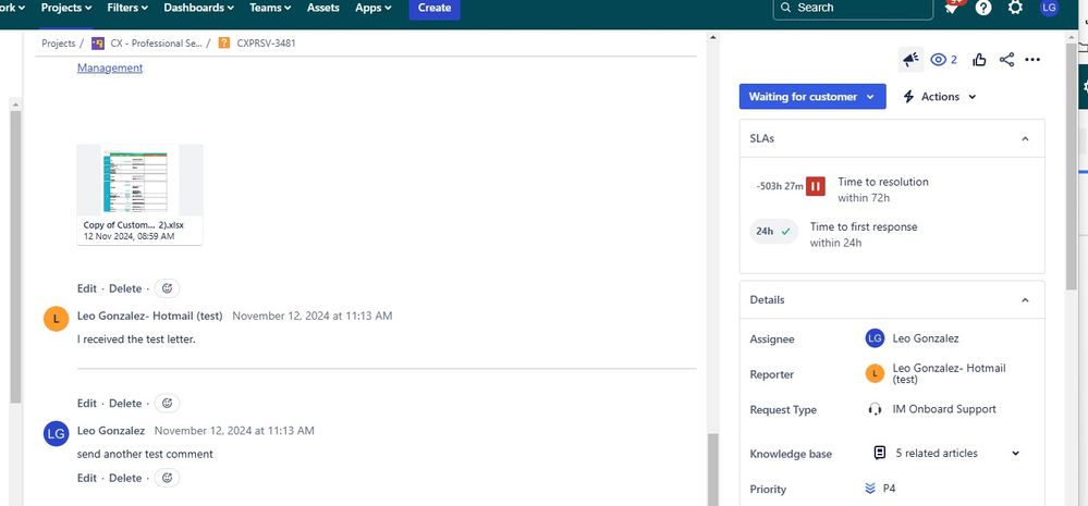

The test with the assignee and report:
Leo

I ran the rule again and here's what I see in the log
