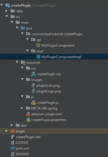

Currently I am stuck on how to place the button onto my issue.

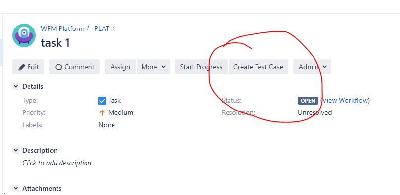

I tried to create a Web Item (circle in red) on the issue page, but I don't how to proceed further to "migrate" the code over.
<web-item name="Create Test Case" i18n-name-key="create-test-case.name" key="create-test-case" section="transitions-all" weight="1000">
<description key="create-test-case.description">The Create Test Case Plugin</description>
<label key="create-test-case.label"></label>
<link linkId="create-test-case-link">/projects/PLAT/issues/</link>
</web-item>
Can someone give my any suggestions on where or how to put my code for the button onto the jira plugin?  Or how to "link" my button code to the web item?
