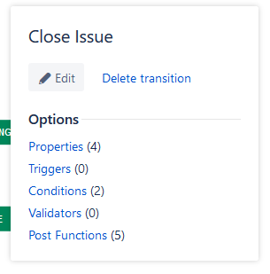

I think in look at workflows I may have already found the fix. It looks like if I go to add a "transition" within the work flow, I'm prompted for a "Screen" to add.
Should this be all I need?
That is indeed the place where you add the screen to appear at your transition. Just one more thing: when resolving/closing an issue, make sure to also add a Validator to make sure Resolution is treated as a required field.
Okay great, thank you!! I'm seeing where - once I have a specific transition selected in the workflow - I should be able to change that. Appreciate the tip! :)
I think, in looking at our workflow, I may have already found the fix. It looks like if I go to add a "transition" within the work flow, I'm prompted for a "Screen" to add.
Now I just have to do my previous fighting with workflow drafts to make the changes. :)
Hi Liz,
yes you are right. The Resolve Screen is typically a transition screen which is connected to the transition by setting it as screen in the worfklow editor. A similar screens could be for example a comment screen, which is just an empty screen connected to the transition.
You can switch screens by editing your transition and selecting another screen. If you add the resolution field to a screen it's automatically a required field.
