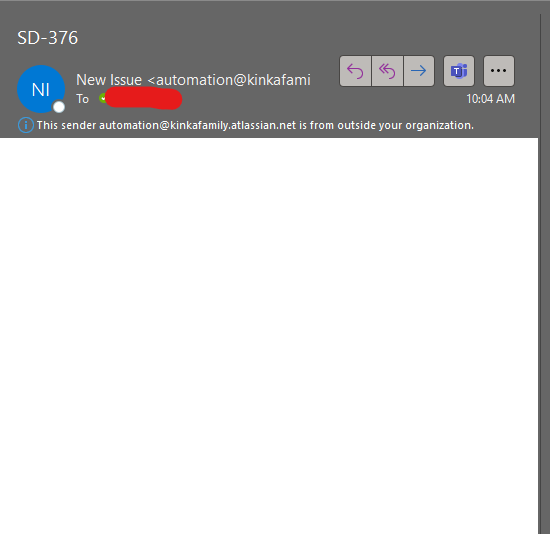

Kinka Family IT
July 25, 2023
Hi Mark
Thank you for your reply, unfortunately that didn't work

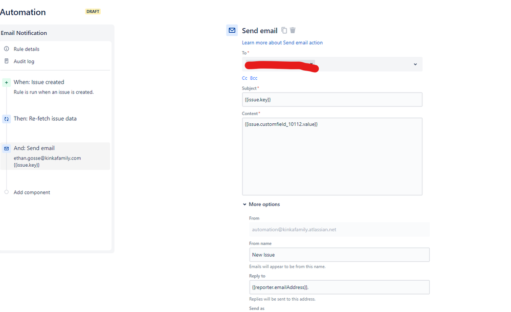

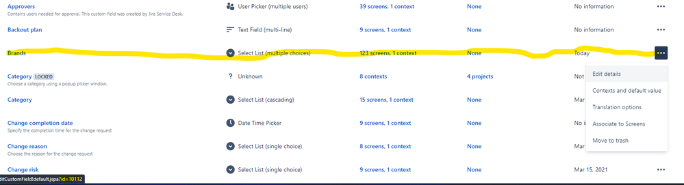

Kinka Family IT
July 25, 2023
I noticed my custom value are not set to a specific project, could this be why they are not showing?
Mark Segall
July 25, 2023
You'd have issues selecting values if the field context was the problem.
Can you confirm that the field is in fact set during issue creation?
Mark Segall
July 25, 2023
Nevermind - Just saw one of the other community members ask the question.  So the issue is being created and then the field is set by automation after it is created?  If that's the case, you may want to change your issue trigger to Field Value Changed.  This would mean that the email would go out any time that field is changed, but it would assure that you're not running into automation collisions.
Note - You would also need to check the box in rule details to allow the rule to be triggered by other rules.

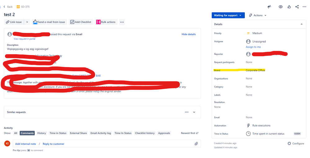

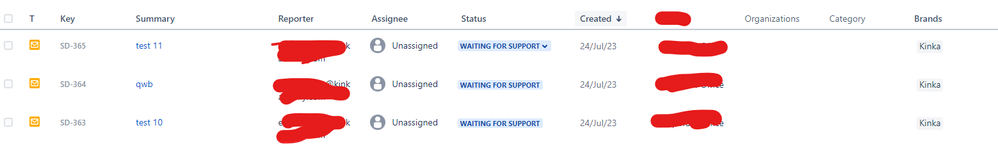

Kinka Family IT
July 25, 2023
Hi
There is a automated process which chooses the value based on the senders domain name
Here is a screenshot of a issue
thank you for your help
Like Marc -Devoteam- likes this

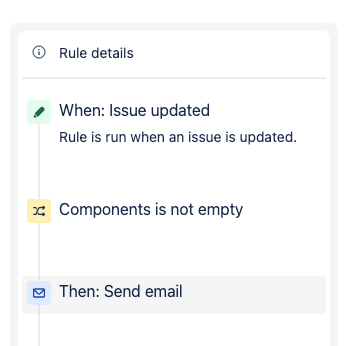

Marc -Devoteam-
July 25, 2023
So @Kinka Family IT
When the issue get created an automation runs to set the brand, if I'm interpreting you correctly?
To sum-up:
  1. Issue gets created
  2. Issue created
  3. Automation to set the Brand field
So if the brand is set automated, you can only use the value in the field when that field is populated.
The I would suggest to change the automation, to not to be on issue creation. Set an automation on issue updated.
Change the Issue Field Condition Components to Brand.

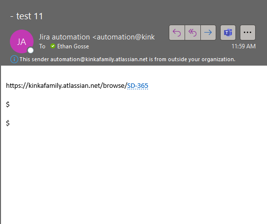

Kinka Family IT
July 24, 2023
No, as you can see no values are being shown

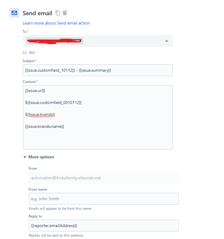

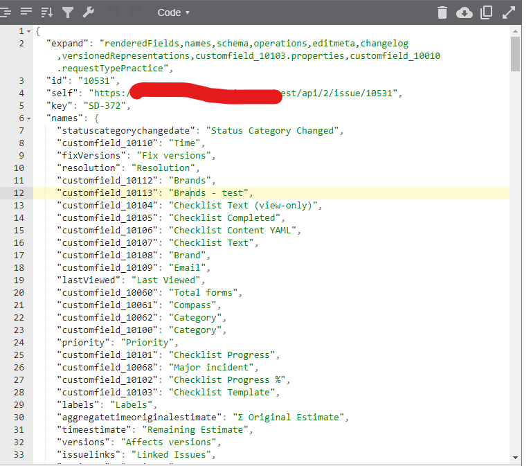

Kinka Family IT
July 24, 2023
These are the values I have tried and the corresponding JSON for reference
{{issue.url}}
${{issue.customfield_0010112}}
${{issue.brands}}
{{issue.brands.name}}
${{customfield_10112.value}}
$ {{issue.fields.customfield_10112.value}}
{{brands.value}}
{{issue.brands - test.value}}
