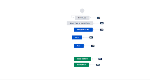

here is the workflow that i'm working on:  Workflow in the project.png
The new status are Investigating, Root Cause Identified, Waiting for Review.
When i look at the Status screen there are 49 workflows now associated with Investigating.  It should not be in most of those.

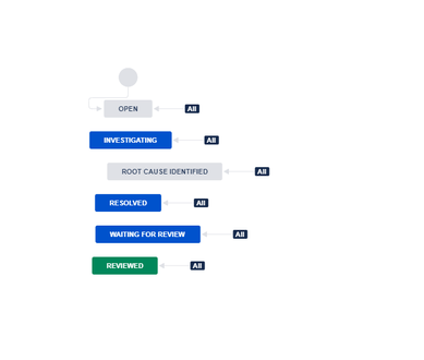

Here is a screenshot of one of the 49 workflows that it was added:

John Funk
October 9, 2019
Agreed - it looks like the name of one of the statuses was changed to Investigating. Do you know what the original name of the Status was?
To change it, go to Jira Settings > Issues > Statuses and change the name of Investigating to the original name that it should be.
Then you can add Investigating to the single workflow as initially intended.

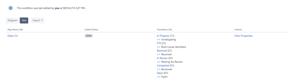

the workflow is specific to the project.  When i look at the workflow there are transitions ids that do not make sense as the fields are not in the workflow.
In the screenshot, you can see Step Name "Open", has a Transition to In Progress (11)>>Investigating...etc.  All of those transitions are not valid.  However when i look at the diagram it just shows to all.  Annotation 2019-10-09 102915.png

Nic Brough -Adaptavist-
October 9, 2019
Workflows do not "go to fields".
The (part of the) workflow you are showing is of the transitions from Open to other states (status).  The transitions are all "valid", or they would not there.
Are you sure you are looking at the workflow you intended to look at?
