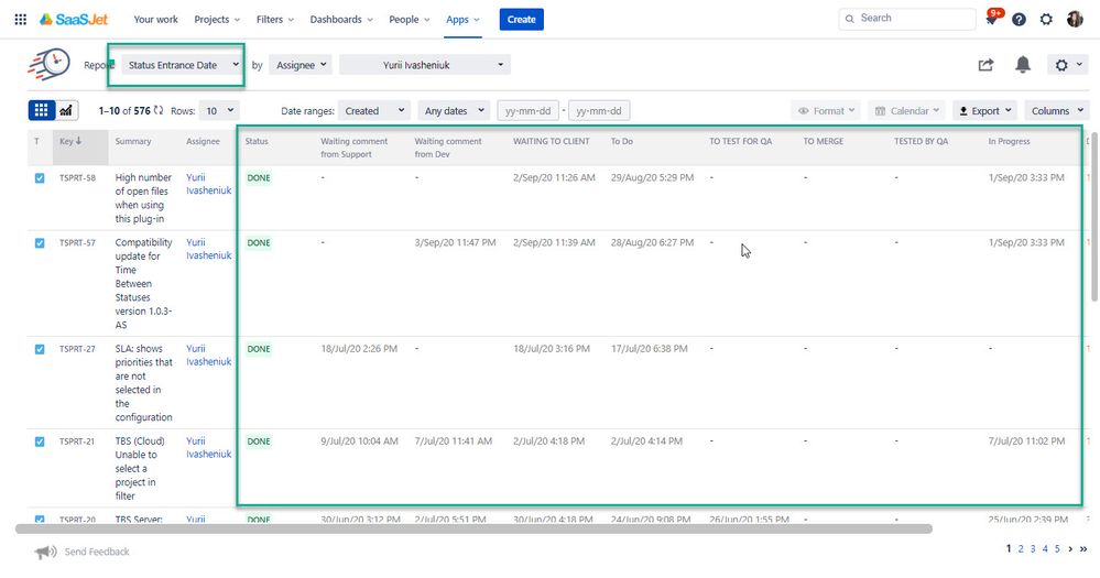

There are 2 solutions, which can be helpful!
Time in status for Jira Cloud generates Status Entrance Date report, which shows the date and time when the issue has entered each of the statuses, and + data points like a key, reporter, status etc, and some additional custom fields.

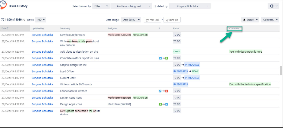

Issue History add-on tracks all the changes that have been made to each issue, including status change, and the author of changes.
