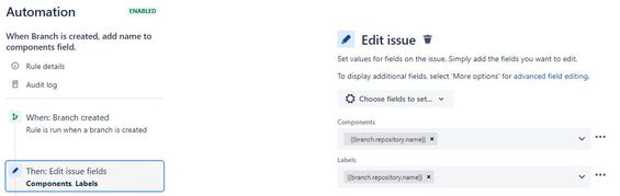

We are trying to automate this process using a mixture of Jira automation and jitterbit functionality. Ideally, what we want to happen is:
  1. When a branch is created, the repository name of the created branch should appear in the Components field.
  2. Jitterbit should then be triggered to look to the Component field and then identify the latest release with that repository name and add that release to the 'Fix Version' field.
Problem:
We are currently having trouble with the first step in this process and hoping someone could help us. We currently have the following automation rules set up:
When a branch is opened, the repository name should be added to the components field and the labels field (with the labels field acting more as a check to see if its working since it doesnt rely on pre-filled choices like the components field.)
We then added all of our repository names to the list of components and tried running the automation. Unfortunately, we are having some weird mixed success where repository names are working and some are not.

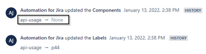

For Example, api-usage, one of our repository names works correctly and writes to the component field when the branch is created:
However, p44, another repository does not work, despite being included in the components list and the label field updating correctly:2022-01-13 16_03_01-[AT-3765] Test Jira Automation with Craig - Jira.png2022-01-13 16_01_55-[AT-3765] Test Jira Automation with Craig - Jira.png

Im a fool. Turns out there was a space in front of a few component's names when I entered them in. so p44 was actually _p44 when you edited the component.

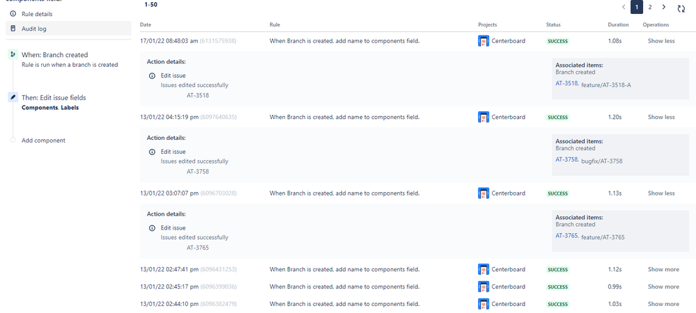

Are you able to share what you're seeing in the Audit Log when the rule is running?
You can read more about using the Audit Log to troubleshoot here:
https://support.atlassian.com/cloud-automation/docs/what-is-the-automation-audit-log/
Cheers,
Charlie
Craig Cinder
January 17, 2022
@Charlie Gavey I used the audit log to try and diagnose the problem. Unfortunately, it doesn't seem to help with this particular issue much.
The rule always has a status of "Success" so it is executing when a new branch is created. However, it always says the issue in question was edited successfully, even when it does not.
