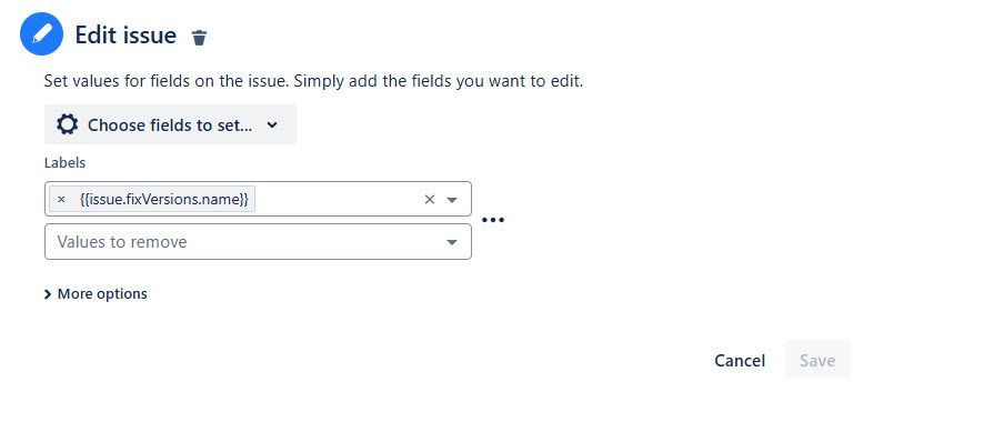

It always overwrites instead of adding - what has to be changed, so it does not. I tried several ways...

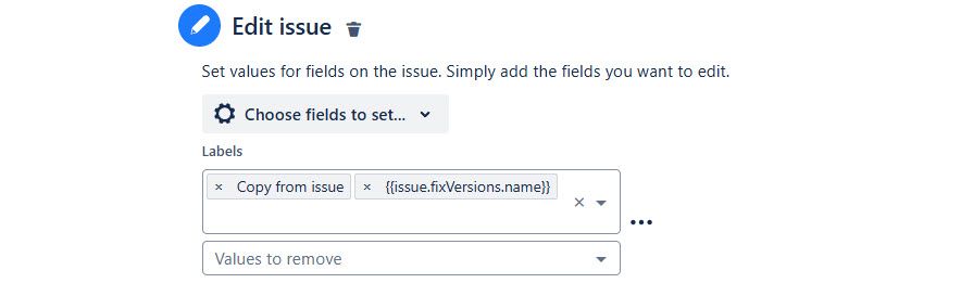

Replace the smartvalue in your screenshot with {{issue.fixVersions}}
Additionally refer to 'To edit the field without overwriting its original content:' section of https://support.atlassian.com/automation/kb/how-to-update-a-select-field-multiple-from-the-content-of-other-fields/

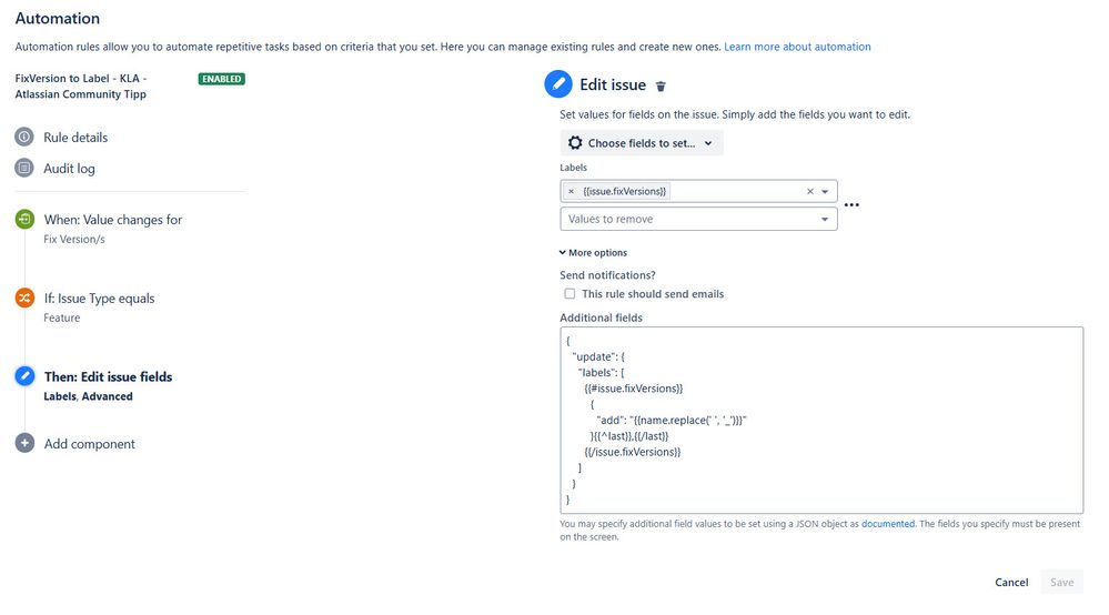

Image of the complete automation:

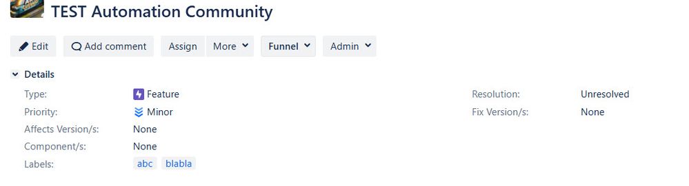

Issue before Automation:

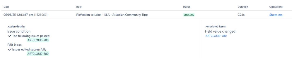

Audit log says it is successful - which it is, it has set the label. BUT it also did overwrite!!!

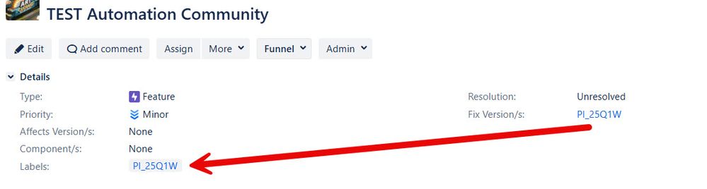

Issue after Automation:
Why does it do this? It's so not logical, in a bulk change it is possible to add and still have the labels from earlier on.

When using the Edit Issue action, a field may be selected from the dropdown list or updated using JSON with "additional fields"...but not both in the same action.
And...I note you changed the dynamic JSON to use both single and double-quotation marks.  That will not work, and it is why I used the asJsonString function:
{{name.replace(" ", "_").asJsonString}}
If you are certain your version names will never contain spaces, you may simplify what I suggested earlier to remove that logic:
"update": {
"labels": [
{{#issue.fixVersions}}
"add": "{{name}}"
} {{^last}}, {{/}}
AND, I fixed a typo from my earlier post as it was missing the pound sign # in the iterator.  Please add that to your expression.
Please deselect the field from the dropdown list, update the expression, and re-test.  Thanks!
