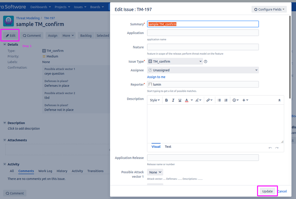

I want to run a post function when the update button available on an issue is pressed. How do I do that? I am not finding a way to do it. is there any way I could do it? I am already having the script running in the script runner console but do not know where to put that script.
Thanks
here are the steps I will be taking

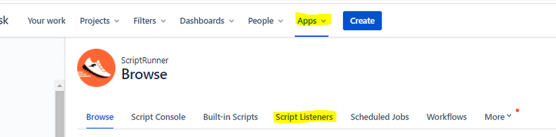

You can find the script listeners (you mentioned you have the scriptrunner console so I assume you have scriptrunner installed) in the options of scriptrunner.
When you go to Apps - Scriptrunner for JIRA you can see the Script Listeners:

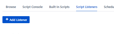

or you can go to:
https://[yourenvironmentname].atlassian.net/plugins/servlet/ac/com.onresolve.jira.groovy.groovyrunner/script-events-admin?s=com.onresolve.jira.groovy.groovyrunner__script-events-admin
There you can add a new listener
