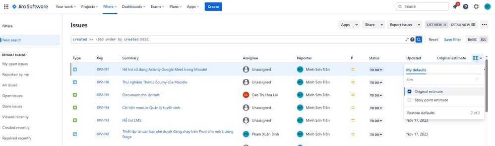

Hi all,
I would like to show the timespent column in my filter. If there is a way to sum up the value in this column then it is even more interesting.
However, I got stuck right at the beginning. In the Configure Columns there is no timespent column. In the window of JQL, I can only specify the fields for filtering, not for selecting.
Please help me to show these precious information in my custom filter
Many thanks

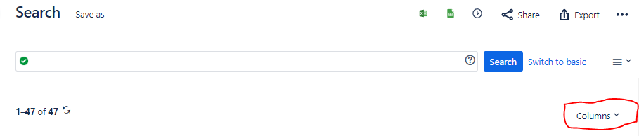

Hi Son,
You can include all the columns you want - the dropdown for this is on the right side just above the list of your issues:
Then simply choose "Time Spent":
Once you save your filter this column will be visible whenever you execute the filter.
Hope this helps, Matt
Son TRAN
November 18, 2023
Dear Matt,
Thank you for your response. Which version do you use? I use the cloud version, and I cannot find the Time Spent among the proposed column
Please show me how I can add the Tiem spent from our GUI (Jira Cloud)
