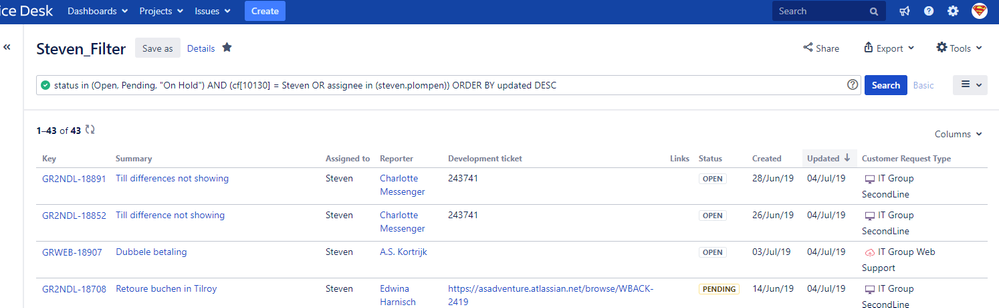

What i need is that i can add the 'on hold' (not required field)  value at my personal filter(see attchment)
So i can see in a glimpse why something is 'on hold'

screenshot filter

Hi Earl,
That's what i tried the 1st time also , i tried again and hopefully it's loaded correctly.
