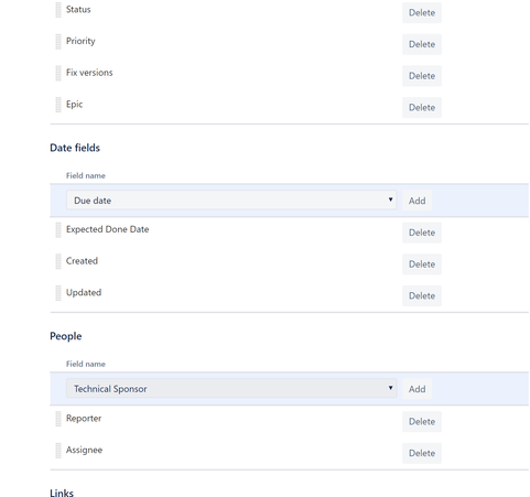

In my project's settings page, this is one of the existing date fields I can add to the list of the Issue Details View (screenshot below). Adding this field would be the same thing as adding the Due Date or Resolved Date to my issue.
By the way, I also tried adding the Due Date in this list and it was also not reflected in the fields available to be filled in the issues.

So I do believe it is a custom field. I suspect the issue here is that while you may have the "Expected Done Date" as a global field you have not added it to your screen for the project in question. A couple of ways to do this but here is one I suggest...
  1. Jira settings
  2. Issues
  3. Custom fields
  4. find the Expected Done Date and click on the ellipses to the right. Do you see the screen(s) associated w/ your project? I expect not.
  5. select Screens
  6. find the screen(s) for your project and click the checkbox
  7. scroll to bottom and update
  8. navigate back to your Kanban
  9. select an issue on the board
  10. in the pop up select show more
  11. do you see it???

Check the screens for the custom  "Expected Done Date", make sure you have the screens from your project selected, especially create, edit and view screen if you are using.
Then after doing so, to display the field on the screen, the value has to be present in the issue.
After that what you have done is correct
Make sure to check the context, field configuration, screen to make sure your "Expected Done Date" field is added.
