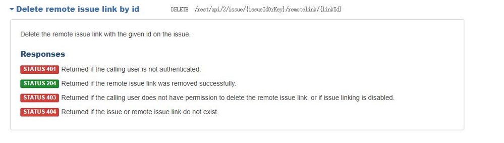

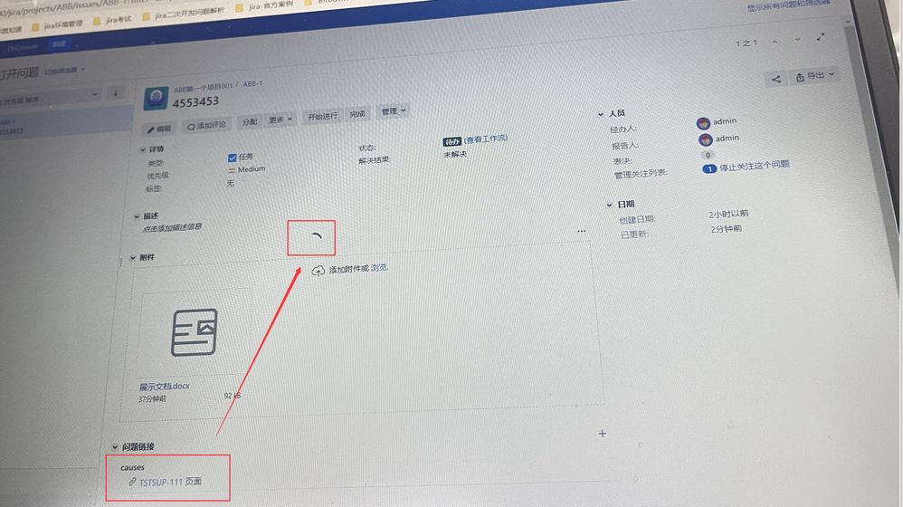

Add/Deleting remote issue links through restful api can cause the page to keep circling

It has been solved. Because I used the issue listener, when the page was doing Update issue, I was also doing Delete issue in the listener, resulting in the conflict between the two actions and locking the table

The custom IssueEventListener listener is created. The current work order is modified through the REST API in the listener, causing a transaction conflict and locking the Project.issue table
