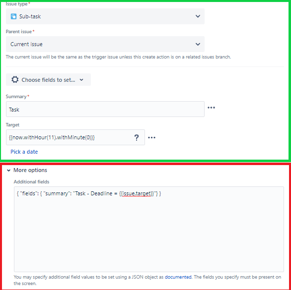

Using Jira Automation, I'm trying to update the summary field with a custom field [Target] (field type = date time picker).
I have two automation rules. 1. Creates a standard issue type at a point in time. 2. Is triggered by the first and creates a list of sub-tasks. The problem is with the second part and the following information sheds some light below.

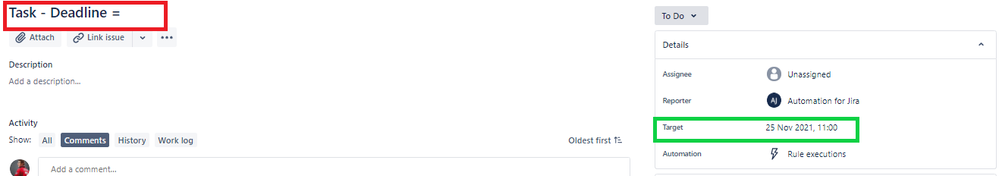

Part of the automation rules runs as expected where it creates a list of sub-task with a summary and adds a value to the custom field [Target]. It seems the JSON is failing to input the custom field and append it to the summary despite the Audit logs showing as successful.
  • Expected outcome is Summary "Task = Deadline = 2021-11-25 11:00"
  • Actual outcome is Summary "Task = Deadline ="
Automation rule (green is working / red is failing):
Output:
I've also tried to run the script with the custom field id but to no success - {{issue.customfield_00000}}. Furthermore I've been able to test the rule with {{issue.created}} and it's working as expected. Not sure if the problem lies with the custom field type I am using.
Reason for automation rule
The 'Additional Fields' JSON to update the summary is being used as a workaround as in Jira Cloud it seems that updating the system setting 'jira.table.cols.subtasks' does not work.
Ideally don't want users to click onto the sub-task to see the deadline for each task and would rather see run order of the sub-tasks on the standard issue, hence my direction of travel with this script.
Eventually I'd like to use {{issue.target.shortTime}} smart value to just produce the target deadline in time format only (11:00).

Hi @Sean McC ,
Is it a option to put
Task - Deadline = {{now.wtihHour(11).withMinute(0)}}
directly in the field Summary in your rule?

Cheers Marco, I'll give it a go now and will confirm shortly.
Ideally I'd like it to be driven from the custom field so I have the potential to run another rule to dynamically update should a user update the custom field however this is a good workaround so thank you!

Quick update: the workaround works as expected. I've added '.shortTime' to enhance readability:
Thanks @Marco Brundel, I'll accept your answer.
