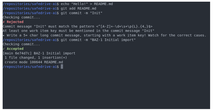

What you can consider is to enforce linking a Jira issue to each commit.
In your Repository Settings, you can go to Links and toggle the "Require issue keys in commit messages".
Have a nice day! Rik
