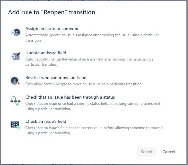

I don't see a way to add post functions to the workflow.  Team managed projects don't seem to have a lot of the things that have been suggested here in this thread and that are shown in the documentation.  The only thing I can add to a transition is a "Rule", and for that I have the below options.  If I select "Update an issue field" the only fields I can access are the Description and Labels.
