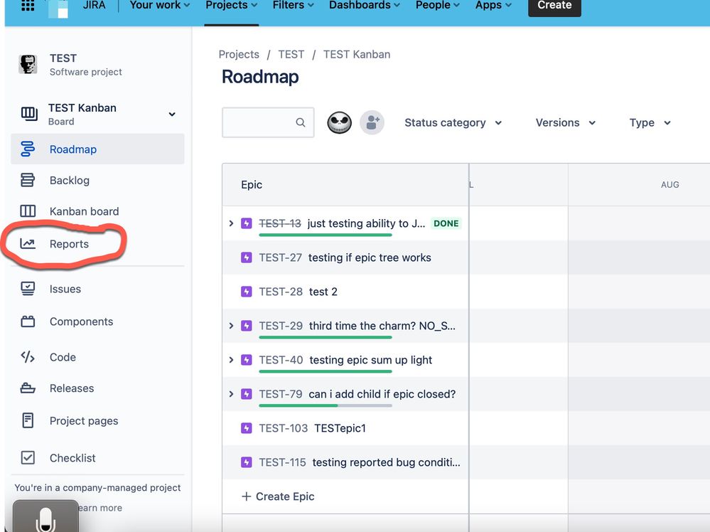

Can you share an image of your project screen? It may be that you are on a TMP project. If that is the case and you don’t see reports in the sidebar then it may be that that is not turned on. For that project admin would need to go into project settings > features and turn on reports. Also for TMP projects you don’t have the “sprint report “but you do have a sprint burn down which will also achieve your goals I think.
If you were on a CMP project then reports should definitely be there and you do not need to be a project admin to see it.

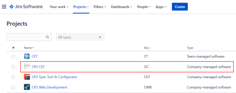

Here is a screenshot of all the projects I have access to. The boxed project is the one in question.

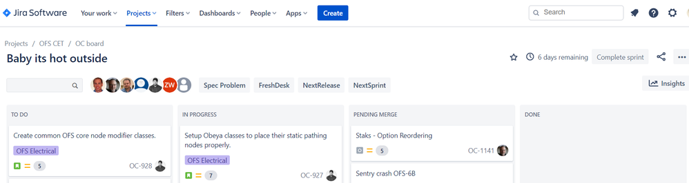

Once I click on this specific project, here is a view of the next screen:
Thanks for your help!
Aha! That sidebar was collapsed. This is perfect. Thanks so much for the help!!
