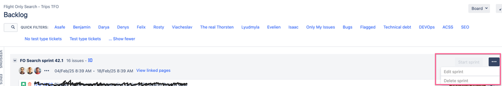

Isaac Kan
February 4, 2025
Thanks for your response. I've had a look at my permission and roles and it seems like I have the same access as some in my team who is able to edit / create new sprints.
If you see attached image, we don't have any filters applied to the project, as such I see all items for this project. In addition, I've highlighted where you can see the action buttons are greyed out.
Any other suggestion would be appreciated.

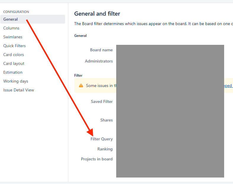

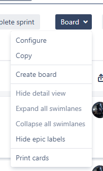

When I spoke of the filter I was not speaking of the Quick Filters shown in the screen image. I was speaking of the filter on which the board is based.
The view that you have to click on the Board button in the upper right corner, then select Configure
Then select the General Configuration option and look at the Filter Query information.
