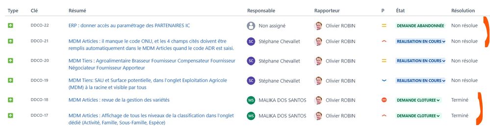

Olivier ROBIN
January 20, 2023
Dear Dave,
The issue is more about the resolution field. Sometimes it is not considered as closed :
Any idea please? Thanks

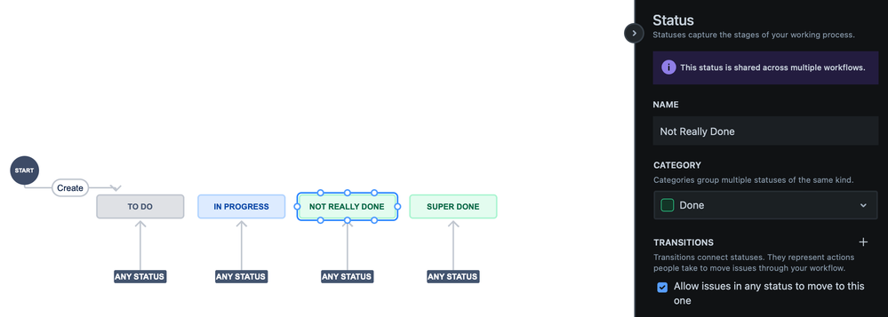

@Olivier ROBIN - you need to do this from the team-managed board.
  • Go to your team-managed board
  • Click the menu "..."
  • Click "Manage workflow"
  • Check each Status that should be Done
  • Ensure the Status's Category is set to "Done"
Of course, your interface may be in French, so I'm not sure what the steps are for you ;p

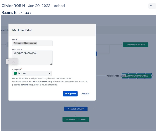

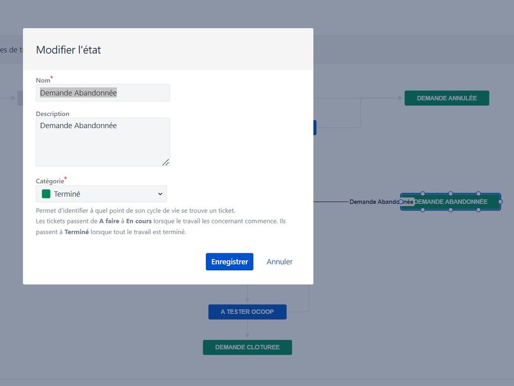

Olivier ROBIN
January 20, 2023
Seems to ok too : 1.jpg
May be a side effect of the setup phase I have done ? Meaning are the tickets modified retrospectively ?

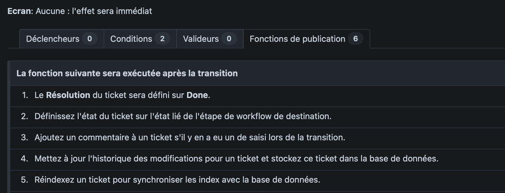

@Olivier ROBIN - when configuring your workflow, before each Done status, you will need to make sure you have a Post Function that sets Resolution to Done.
(OR, have a screen presented during the transition that allows you to set Resolution. The screen should have the Resolution field in it.)
