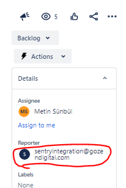

Hello,
As in the picture;
In some projects, when "reporter" is sentryintegration@gozendigital.com, I want "assignee" to be the person I want.
When the reporter is "sentry" after the ticket is received, "assignee" will be metin.sunbul in the example GSS-Gohub project.
How can we automate?

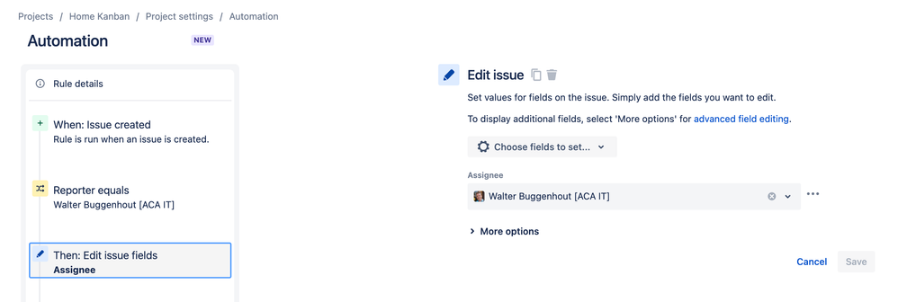

Hi @Barış Özer,
A setup like this should do the trick:
The condition (the second step in the rule) is a Field Value condition on reporter. In steps 2 and 3, just replace the reporter and assignee with the values you need.
Hope this helps!

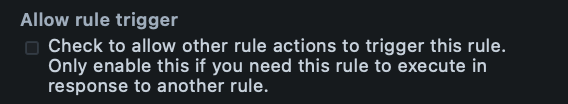

I don't understand what it means?
If I mark and save will the rule work and replace "assignee"?
I don't understand do I have to mark it?
"Allow rule trigger
Check to allow other rule actions to trigger this rule. Only enable this if you need this rule to execute in response to another rule."
You only need to check this option if you want to let your automation rule be activated by another automation rule. From what your describe, I cannot see why you should need to check this.
Your automation will run every time an issue is created in your project (that is what the Issue Created trigger (the first step in the screenshot) takes care of. There is nothing else you need.
Then I don't mark it.
