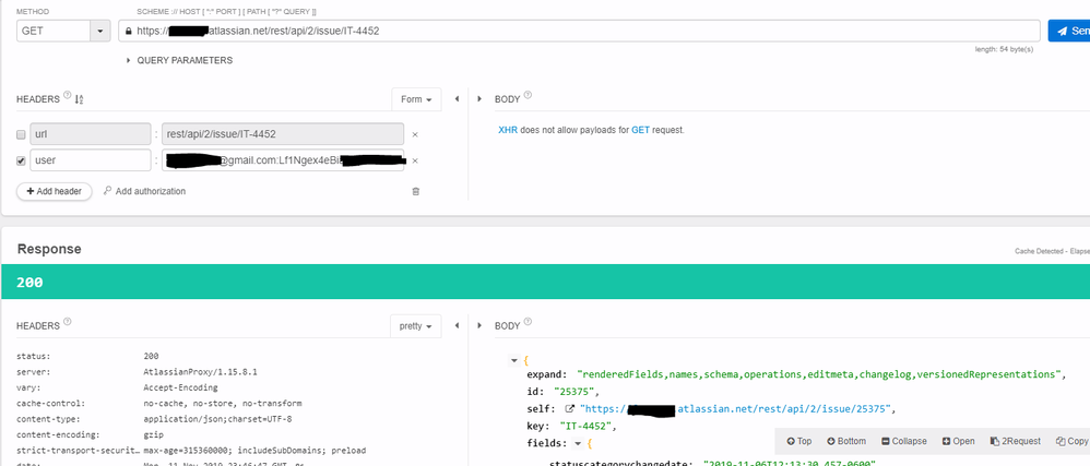

  • I have verified that the in-browser plugin makes the request as expected (and in fact ignores the "user" header) when I am logged in to either account in the same browser. I have attached a screenshot of this.
  • When not logged into Jira, and using exactly the credentials in the screenshot, I get a 404 response with the error message "Issue does not exist or you do not have permission to see it."
I have exhausted troubleshooting options and the only thing I can think of is that perhaps the fact that we have SAML active on our account is causing problems with the API tokens? (SAML has caused weird issues for us in other areas before.)
Screenshot of a successful query from a browser plugin while logged into the associated Jira account in a different tab in Chrome. This fails with a 404 if I make the same query after logging out in the other tab (i.e. without the associated login cookie active in the browser).

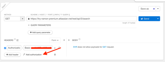

Apitokens shouldn't be affected by your team's implementation of SAML. With or without SAML, apitokens are used to authorized API calls into Jira cloud via Basic Authentication.
To use that, you will need to add an authorization to your rest call.
The username will be your email address and the password is the apitoken string. Talented will convert that for you into the proper Authorization header which will be sent out with the rest call.
I hope this helps.

Brandon Lawler
November 14, 2019
Looks like this was entirely a mistake on my part. For both the browser plugin and for the product I'm trying to integrate to Jira with, I was not properly generating credentials. This resolved my problem. Thank you!
