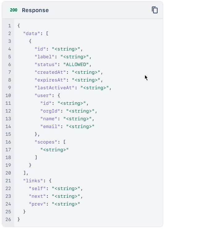

List/Read API Tokens Definitely so Retrieve Expiration date should be doable.
curl --request GET \ --url 'https://api.atlassian.com/admin/api-access/v1/orgs/{orgId}/api-tokens' \
Rotate - I don´t think so at the moment.
The API Access REST API

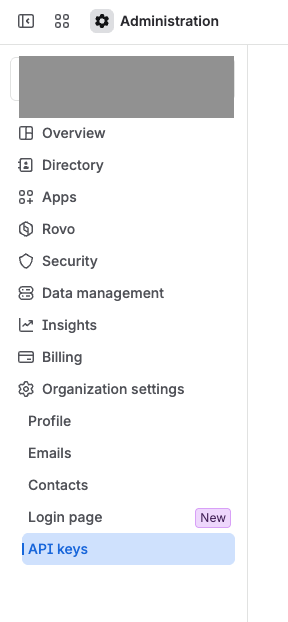

In this case "key" and "token" are essentially the same thing. The difference is that the process needs Organization Admin level access to see all the API token names and expiration dates across all accounts in the Organization. The only way to get a "token" that has Organization Admin level access is to generate it from the Admin Hub > Organization Settings > API Keys. That can be done only by an Organization Admin.
