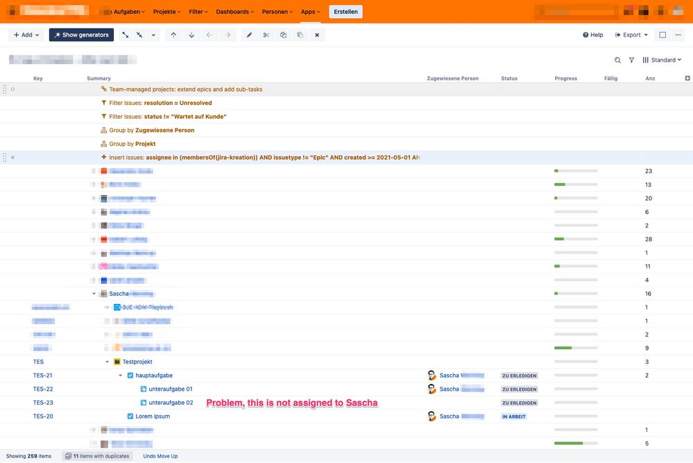

Hi guys,
I would like to create a Structures View with following output:
-Employe A
    -Project A
        -Task A01
            -Subtask A0101
            -Subtask A0102 (Employe B)   <-- PROBLEM
        -Task A02
            -Subtask A0201
    -Project B
        -Task B01
            -Subtask B0101
+Employe B
+Employe C
So I want to see Tasks and Subtasks by Employe.
Problem: There are subtasks in the list assigned to other people than the "root".
Thanks for any help.
Regards,
Sascha

Fabian is on the right track, @Sascha We.   Can you share a pic/copy of your Generators, please?
We'll get you sorted.
-dave
Sascha We
December 28, 2021
Thank you for your answers! Here comes the picture.

Sascha We
December 29, 2021
Hi David, thanks for your reply :-)
Yes, my goal is to see all open work assigned to each user starting by User > Project > (Epic) > Task > Subtask.
Epics would be nice so all jira "hierarchy elements" would be used. When the task is assigned to another person B this task should be visible to keep the hierarchy structure to the subtask assigned to user A (root of tree element)
When there is a mismatch, A0102 doesn't have to appear in the list because it's not assigned to "root user".
Vice versa, when a subtask is assigned to a user A but the epic/task (parent) is assigned to another user B, the task must be shown for user A. This is also a problem because these tasks are not shown in the moment.
Best regards,
Sascha

Hello @Sascha We
Thank you for reaching out to our support team to discuss your use case and potential solutions!
We identified that the important piece of work to group by assignee was the sub-task.  The structure would look like
Assignee (on sub-task) > Project > Task > Sub-Task
In order to build this hierarchy where the sub-tasks would all match the Assignee group at the top level, we would need the ability to Group Sub-Tasks by their Task.  This unfortunately is not available at the moment.  We do have a task in our backlog for this functionality and have listed your interest there for notification in the future.
What we were able to do was find a workaround where we can use the Quick Filters functionality to drill down to a specific assignee.
We start by using an Insert Generator to add our Tasks, then extend to Sub-Tasks.  We then Group by Project.  At this point, we have Project > Task > Sub-Task which includes everyone's sub-tasks.
Lastly, rather than Group by Assignee we are creating a Quick Filter for each assignee, which is set to filter on the Sub-Task level of the hierarchy.  In doing this, we see Project > Task > Sub-Task (specific assignee).
Hopefully this workaround was useful for you and everyone who may be looking to build a similar structure in the future!
