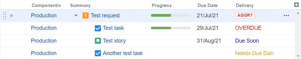

I'm trying to set up a Function column on a Structure view that will:
  1. For each sub-issue under a root issue, display Wiki Markup on whether it is on track, due soon, or overdue based on its Due Date (got this part working)
  2. For each root issue, display Wiki Markup on whether the sub-issue with the soonest due date is on track, due soon, or overdue (can't figure this part out)
Basically I want to roll up the most urgent due date's Wiki Markup to the root issue. Is this possible? Would love some sage wisdom.
Here's my Expr for part 1, and my most recent failed attempt at part 2, if it helps. The root issue type is Request, and its subtree is everything linked to that Request issue or its sub-issues by certain link types.
IF (issuetype != Request;
    IF (dueDate < today(), "{color:red}OVERDUE{color}",
DAYS_BETWEEN(today(), DueDate) <= 14, "{color:blue}Due Soon{color}",
DAYS_BETWEEN(today(), DueDate) > 14, "{color:green}On Track{color}",
dueDate = undefined, "{color:orange}Needs Due Date{color}",
"{color:white}{color}"
or IF (issuetype = "Request ";
WITH x = MAX#subtree{due_date}:
IF (x, "{color:black}x{color}")
 Which is currently producing this:

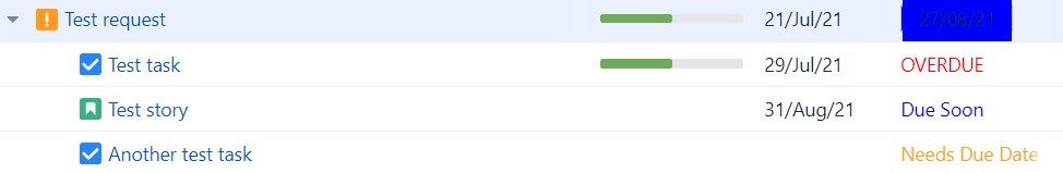

Vye Alexander
August 27, 2021
Dmitrii, Dave, thank you for the response! I tried the above code and it doesn't quite work - all the root issues have that AGGR error like before. After some troubleshooting, I was able to determine that the part it is upset about is the min#subtree{duedate} part. Just to test, I subbed in today() for x and was able to get rid of the AGGR error but, obviously, that's not the value I need for x to make it do what I want.
Here is the change I made from the code above to stop the AGGR error:
IF (
issuetype != "Request";
if (
duedate < today(), "{color:red}OVERDUE{color}",
DAYS_BETWEEN(today(), duedate) <= 14, "{color:blue}Due Soon{color}",
DAYS_BETWEEN(today(), duedate) > 14, "{color:green}On Track{color}",
duedate = undefined, "{color:orange}Needs Due Date{color}",
OR
IF (
issuetype = "Request";
WITH x = today():
if (
x < today(), CONCAT("{panel:bgColor=red}", FORMAT_DATETIME(x, "dd/MM/yy"),"{panel}")
or
if (
DAYS_BETWEEN(today(), x) <= 14, CONCAT("{panel:bgColor=blue}", FORMAT_DATETIME(x, "dd/MM/yy"),"{panel}")
or
if (
DAYS_BETWEEN(today(), x) > 14, CONCAT("{panel:bgColor=green}", FORMAT_DATETIME(x, "dd/MM/yy"),"{panel}")
or
if (
x = undefined, "{color:orange}Sub-issues need Due Dates{color}"
And here is what it produces now:
Any ideas why min#subtree{duedate} wouldn't work? Thanks!

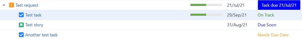

Okay, got everything working! A couple notes:
  1. The issue where #subtree was causing an AGGR? error seems to be related to the version of Structure. We were using version 6.0, but have now updated it to 6.4.0.
    • I think removing the #subtree, as Nicholas suggested, also worked to remove the AGGR? error (I'm pretty sure I tried it before the upgrade was applied) but that wouldn't have solved the next thing...
  2. The MIN{} function would return the root's due date if it was the earliest of the bunch, and I wanted only the sub-items. I switched to using the #strict modifier and that seems to have done the trick!
My final, functioning Expr and Wiki Markup looks like so:
IF (
if (
OR
IF (
WITH x = min#strict{duedate}:
if (
x < today(), CONCAT("{panel:bgColor=red}{color:white}Task Overdue{color}{panel}")
or
if (
DAYS_BETWEEN(today(), x) <= 14, CONCAT("{panel:bgColor=blue}","{color:white}", "Task due ", FORMAT_DATETIME(min#subtree{duedate}, "dd/MMM/yy"),"{color}","{panel}")
or
if (
DAYS_BETWEEN(today(), x) > 14, CONCAT("{panel:bgColor=green}","{color:white}Tasks On Track{color}","{panel}")
or
if (
x = undefined, "{panel:bgColor=orange}{color:white}Tasks missing due dates{color}{panel}"
 Which results in this:
Thanks, everyone, for your help!
