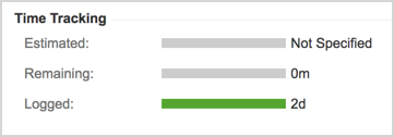

The question is a little misleading.  You can, indeed, log time against a story when you have selected "None" for the tracking statistic.  However, you won't see it appear in the issue detail because there is no Remaining field there.  Also, the time tracking graph will not track Logged vs. Remaining for the same reason.  See screenshot below:

It makes sense to me @jmoritz. Thanks.
