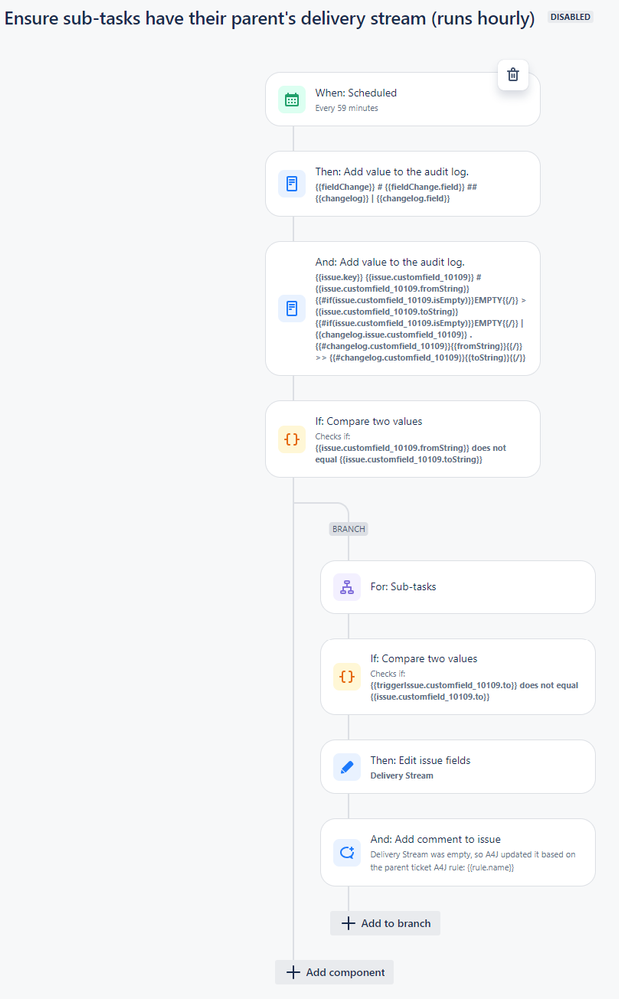

I have a rule that ensures the custom field "Delivery Stream" (customfield_10109) is updates all sub-tasks when the task/story value is changed. That works as expected.
However, there are conditions that can result in a sub-task not having the same value as the parent, e.g. when a subtask is moved to a different parent, or a task is demoted to a sub-task. Those events can't be caught with a trigger as best I can tell.
To cover those edge cases I had created a scheduled task to run every hour on changed tasks/stories (using JQL) and ensure the sub-tasks matched the parent, however this was failing if the Delivery Stream field had been cleared.
These are the 2 log lines I've used to try to capture the change, and the results in the logs from running the rule after setting the field to a value. These are the first steps immediately after the schedule trigger.
{{fieldChange}} # {{fieldChange.field}} ## {{changelog}} | {{changelog.field}}
{{issue.key}} {{issue.customfield_10109}} # {{issue.customfield_10109.fromString}}{{#if(issue.customfield_10109.isEmpty)}}EMPTY{{/}} > {{issue.customfield_10109.toString}}{{#if(issue.customfield_10109.isEmpty)}}EMPTY{{/}} | {{changelog.issue.customfield_10109}} . {{#changelog.customfield_10109}}{{fromString}}{{/}} >> {{#changelog.customfield_10109}}{{toString}}{{/}}
Log action
Log
# ## ChangeLogList{startAt=0, maxResults=0, total=0, histories=null} |
Log action
Log
DFXXSYS-44 Atlas # > | . >>
Help to correct my attempt to capture the change, or a suggestion of a better approach to solve the edge case are both appreciated

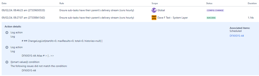

Can you provide a screen image of the audit log? That will show us what the rule thinks it is doing and what issues it is trying to act against.
With that, can you provide screen images showing the complete rule? That way we can compare what is in the audit log to the steps in the rule.
Dave Furlani
March 14, 2024
I played with the rule and after still having no luck I disabled it. Here's the last log and the rule as I left it:
