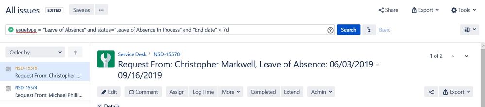

Raj Kumar
February 3, 2020
Hi @Robert Dzido (Almarise) ,
Please find the JQL used it is not giving me the intended result can you please check and help.
Attaching screenshot for your reference.
In screenshot  Start date =06/03/2019 and end date= 09/16/2019
