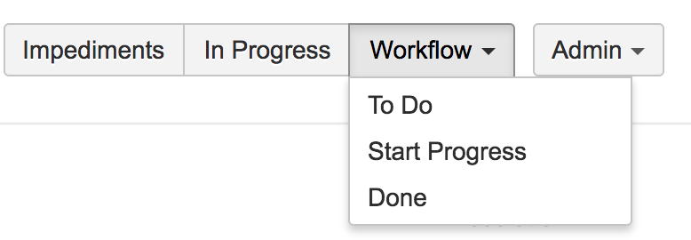

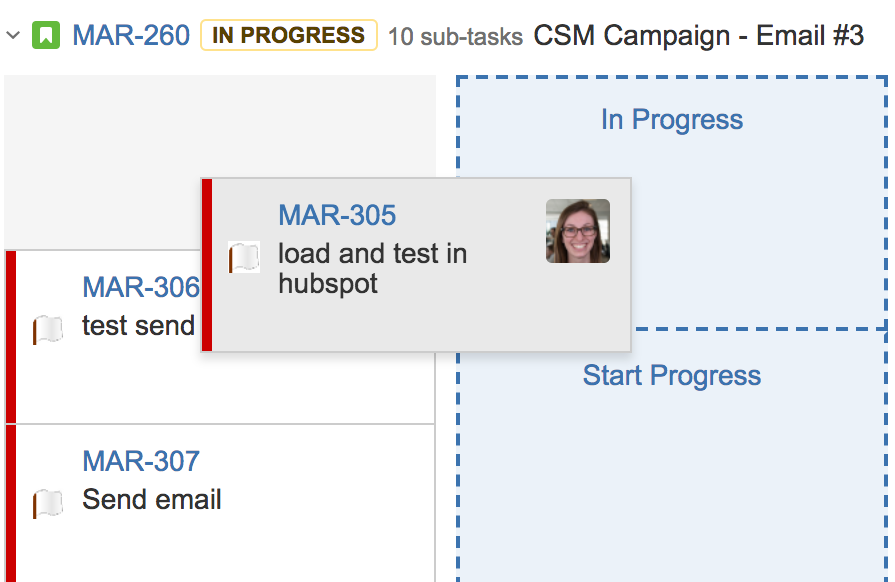

I see this status "Start Progress." It appears in the workflow dropdown of tickets, but it does not appear in my workflow (diagram view). It also appears in the column as a separate option within "In Progress" (see below). I ONLY want In progress, not this split column. Help!!Screen Shot 2018-05-29 at 4.39.12 PM (2).pngimage.png

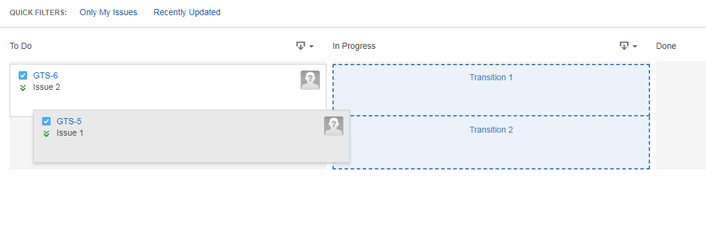

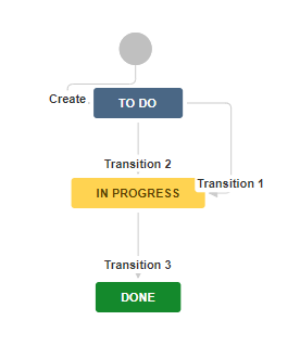

It would seem that your workflow has two transitions (In Progress & Start Progress) that point to the same Status. See my example below where my transitions are called Transition 1 & Transition 2.
Edit your workflow (as a project admin) to remove the additional transition.
Regards Gary

@Hannah McKinney Could you  please make a screen shots of your board setting  configuration?
Hannah McKinney
May 31, 2018
Moses Thomas
June 1, 2018
@Hannah McKinneyThis  is a  transition not a status  in workflow.  if  you  remove this  transition  in  workflow it will  disappear :)

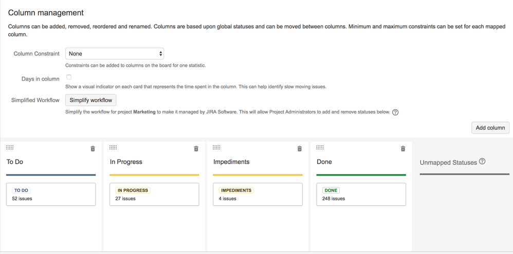

@Hannah McKinneyGo to  board  settings and drag it out. make you  are board admin.
Best!
Hannah McKinney
May 30, 2018
Hey @Moses Thomas , "Start Progress" doen't exist in my board settings/column settings/statuses. I can't find it anywhere except in that ticket view and the board itself.
Moses Thomas
May 30, 2018
@Hannah McKinneyAs  i  know board is taking statuses from  workflow,  but you  can do  like this remove this  in  progress column and add it again with  only one status  see if it works.
Hannah McKinney
May 31, 2018
@Moses Thomas I tried deleting and re-adding the column. There is only one status associated with the column - In Progress. I do not have a Start Progress Status.
Yet, it still shows up on my board. Any other tips?
