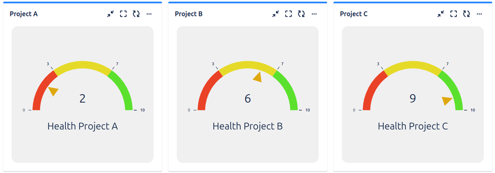

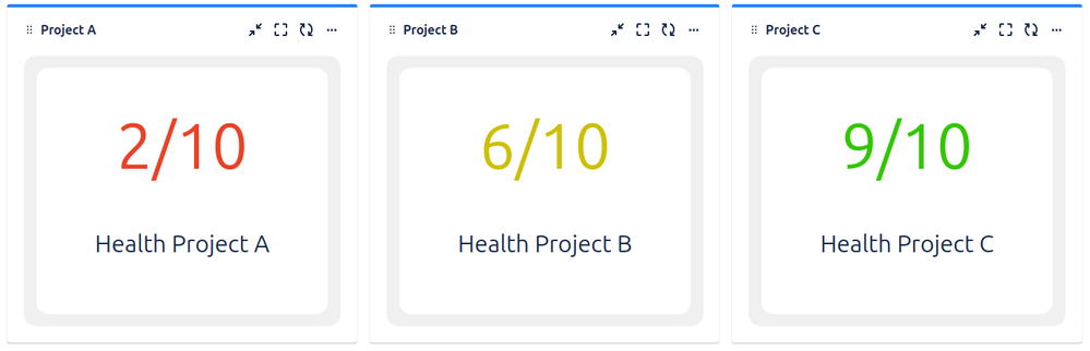

Project Status: Visual indicators (e.g., green, yellow, red) to represent project health
Not sure how exactly you want to determine the project health. The app offers an Issue Filter Formula gadget that that can display numbers in certain colors, depending on the ranges of a value, or as gauge chart. You could use them, to calculate and display the health of a project, lets say on a scale from 1 to 10.
You could have something like this:
Or, like this:

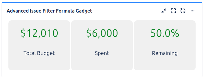

Budget Utilization: Tracks spent vs. allocated budget
By using the Advanced Issue Filter Formula gadget you can calculate and display  the overall budget, depending on how you store it in Jira (USD, hours, etc).

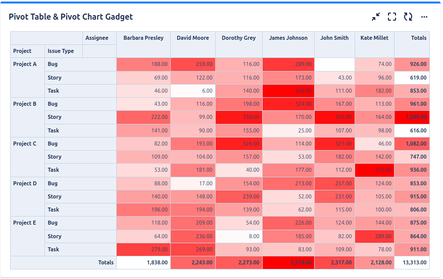

Resource Allocation: Displays team distribution and availability
Team distribution (by project, for example) can be displayed in various forms by using the Pivot Table & Pivot Chart gadget. This is an example of team distribution based on number of hours assigned in every project, split by task type - the gadget supports multi-field stats.
The app does not display team availability.

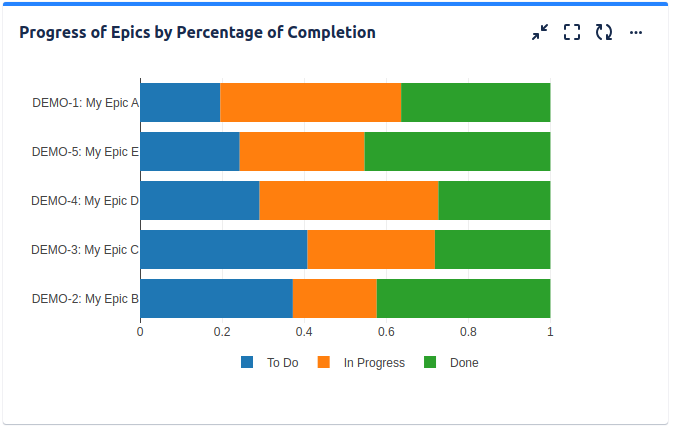

Progress Metrics: Measures task completion percentages
By using the Pivot Table & Pivot Chart gadget you can track the progress of the Themes, Initiatives, Epics and Stories based on their number of child items or sum of story points and display them as tables or charts.

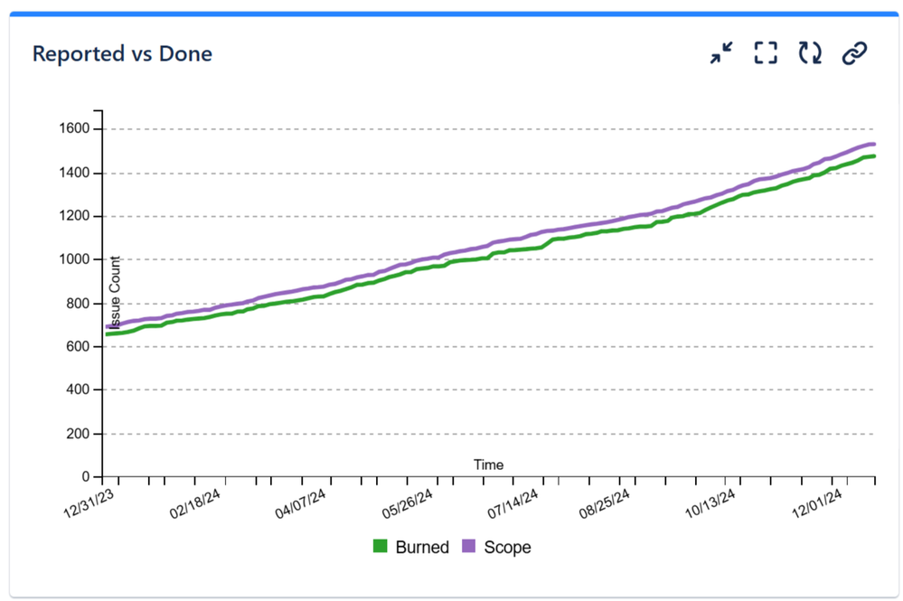

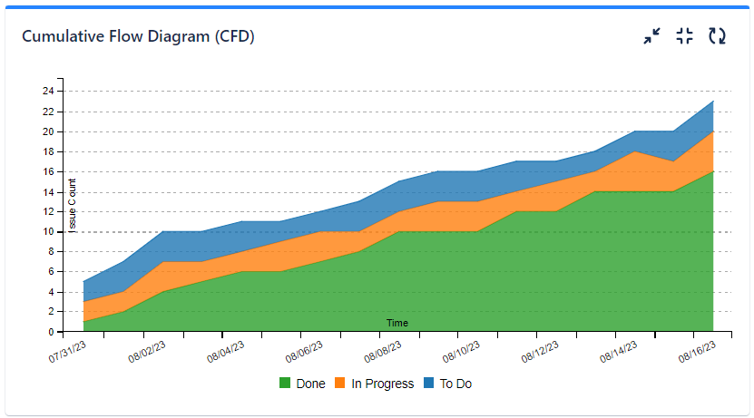

Issue Tracking: Monitors reported and resolved issues
This can be done by using the Release Burndown Burnup Chart gadget configured to display Created vs Done (see https://community.atlassian.com/t5/App-Central-articles/A-powerful-Reported-vs-Done-chart-for-Jira-dashboards/ba-p/2610902), or by using Cumulative Flow Diagram gadget (see https://community.atlassian.com/t5/Jira-articles/Building-a-powerful-Kanban-dashboard-in-Jira-with-Great-Gadgets/ba-p/1664331).

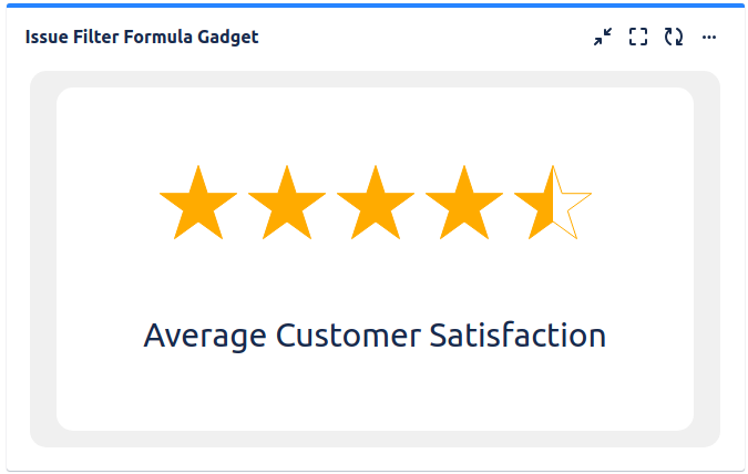

Stakeholder Satisfaction: Collects feedback to gauge satisfaction
By using the Issue Filter Formula gadget you can display average satisfaction score as a gauge chart or 5 star scale. See also https://community.atlassian.com/t5/App-Central-articles/How-to-measure-Customer-Satisfaction-in-Jira-and-Confluence-with/ba-p/2741012
