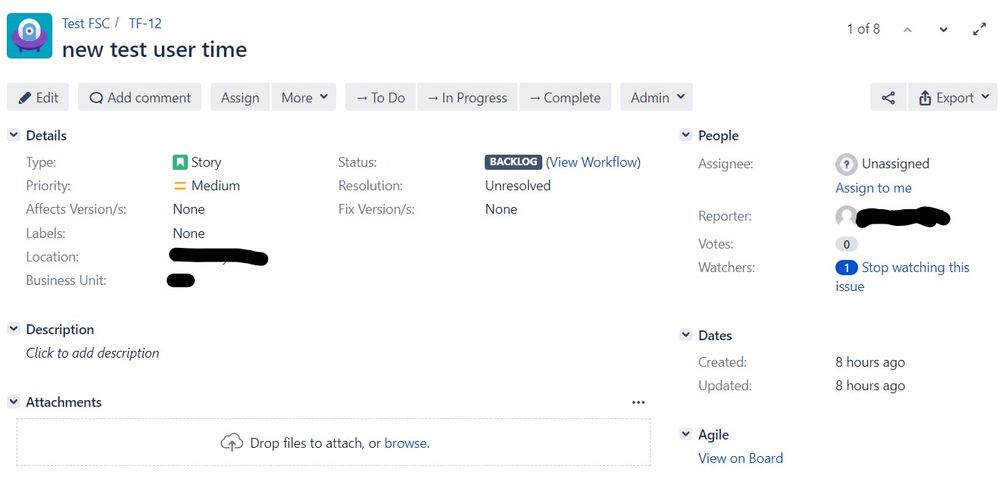

This issue appeares since yesterday.
When I create an issue in Jira, it shows that the issue was created 8 hours earlier.
What has happened, what is the cause?

Harold de Bell
January 26, 2022
Hello @Laura Holton _ACE Manchester_
Thanks for your reaction.
The time in the created issue should be according to the time zone that is in your profile, in any case, how it used to be.
This time zone should reflect the time (for creation, updating, etc) in your issue (independent from the time on the Jira server).
So, how can it be that the time when the issue was created is different from the date in the issue itself (in this case 8 hours earlier than the time zone mentioned in the profile)issue-time-not-correct.jpg
