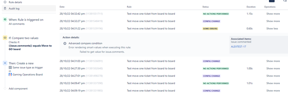

I tried advanced compare option but that didn't work, not sure if there is a smart value that would work with this.
Bill Sheboy
October 31, 2022
Alexis, would you please post images of your rule and the audit log details?  Those may provide some context for suggestions.  Thanks!
Alexis Gutierrez
October 31, 2022
This is what it tells me about this rule..
Bill Sheboy
October 31, 2022
Thanks for that information.  Perhaps try this in your advanced compare condition:
  • first value: {{issue.comments.last.body.toLowerCase().match(".*(move to go board).*")}}
  • condition: does not equal
  • second value: leave this value empty
How this works:
  • get the last comment's body
  • convert it to lower case
  • use the match() function with a regular expression to find your text, returning 0-to-many matchs
  • and test if any were returned...if so, continue processing

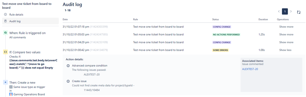

Alexis Gutierrez
October 31, 2022
Close.. it looks like the first part of the rule worked just not the end.
Bill Sheboy
October 31, 2022
That error indicates an issue type mismatch: between the source/trigger issue's project and the target project, Gaming Operations Board
Three of the possible causes of that are...
  • if both source and target project are company-managed projects (CMP), the issue type of the trigger issue does not exist in the target project.  Fix: ensure the type is available in both, or select a different type for the target rather than copy from trigger issue.
  • if both source and target project are team-managed projects (TMP), the added issue types are different.  Fix: explicitly select the issue type for the target project rather than copy from trigger issue.
  • if the projects are of different types, CMP and TMP, the types will not match.  Fix: explicitly select the issue type for the target rather than copy from trigger issue.

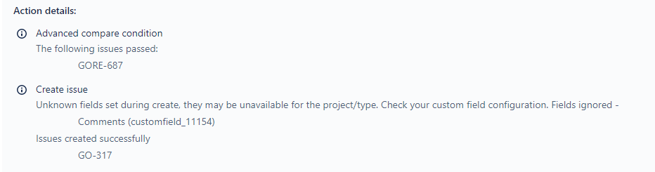

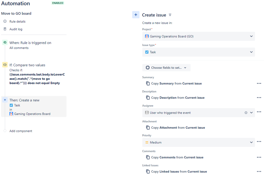

Alexis Gutierrez
November 1, 2022
@Bill Sheboy It looks like everything works but the comments.. Not sure why the comments are not moving over. All the attachments are and other things. I have it checked to move over from the issue.
Bill Sheboy
November 1, 2022
Would you please post an image of the audit log details, showing an example where the rule triggered and the comments did not copy from the trigger issue?  Thanks!
Alexis Gutierrez
November 1, 2022
sure. Here it is below.
Bill Sheboy
November 1, 2022
Thanks!  That appears to be a custom field, and not the built in comment field.  I just confirmed that the built-in comments field cannot be copied directly (as you have shown) with an automation rule.
The only work-around I am aware of is to try to add the comments with JSON from the trigger issue, under advanced edit.  There appear to be some open defects/suggestions indicating this may not be possible, but perhaps give it a try.
