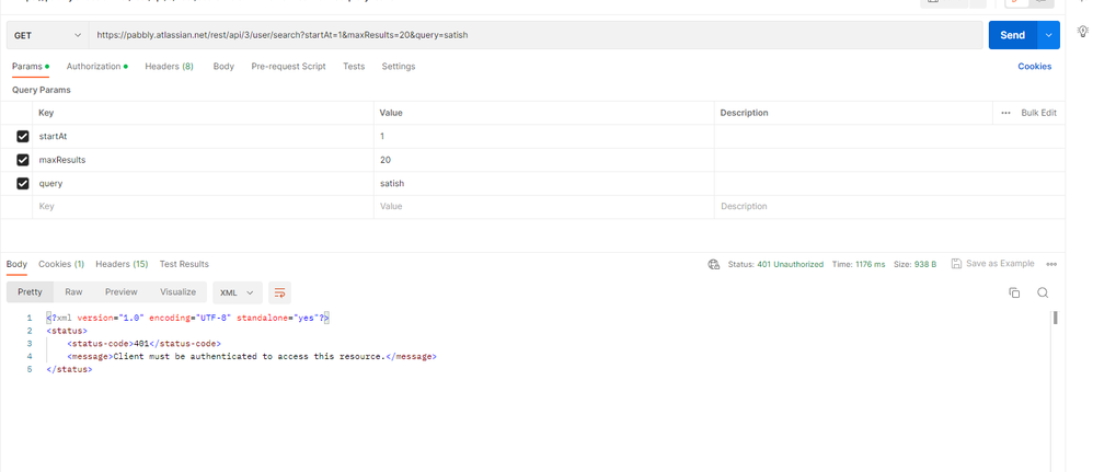

I am writing to bring your attention to an issue that our users are experiencing unexpected error. The user is receiving a 401 error while trying to access our platform.
We have implemented tests on our side to diagnose the issue. Initially, the tests were unsuccessful, but we were able to resolve the issue. However, the user is still experiencing the same error despite our efforts. I have attached a screenshot of the error message for your reference. If needed, I can also provide a curl request for further context.

Do check and let us know about the error our mutual users are facing issues. I am inserting a Screenshots for the same. Provide me with your support email so I can also provide a curl request for further context.image (1).png

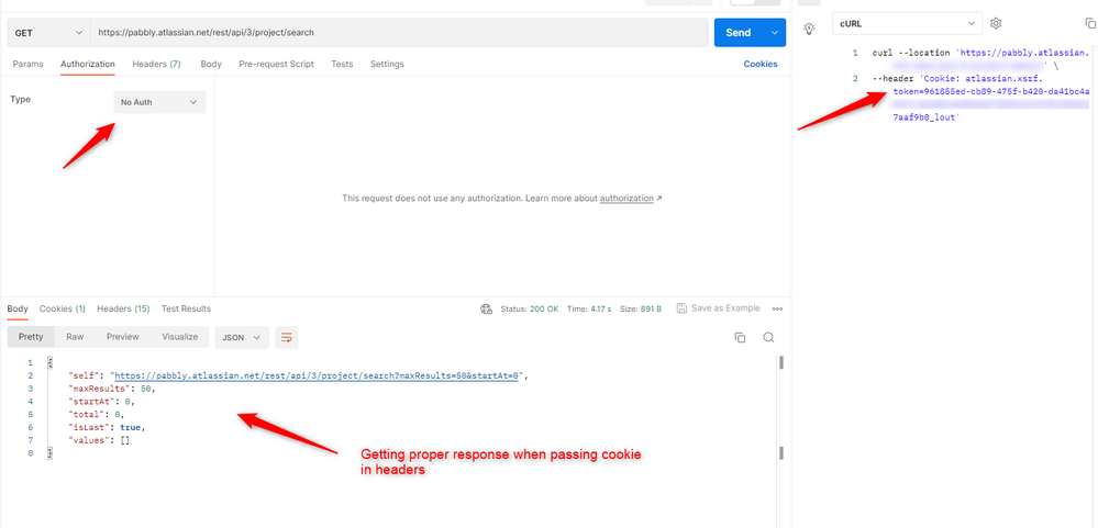

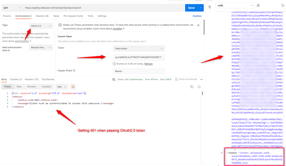

We are encountering an issue with the Jira project list API request in Postman, which involves OAuth 2.0 authentication.
Upon configuring the API request, we have been receiving an error message "401 Client must be authenticated to access this resource" as shown in the attachment. However, we have found that we are able to successfully obtain a response when passing the cookie without passing authentication in the API request.
Further investigation in Postman has revealed that cookies were included in the request. Despite this, we were able to receive a 200 status response for the project list API.
We are wondering if there have been any changes to the API or authentication method since it was previously working correctly. As our mutual users are also experiencing this issue, we would greatly appreciate your prompt attention to this matter.
Thank you for your assistance, and we look forward to hearing from you soonimage (22).pngimage (23).png

This looks like you are not authenticating properly, I am not sure Atlassian can help you if you get auth wrong.
