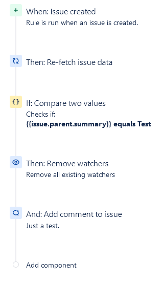

Yes, it seems for the moment you were just running into timing issues where the issues was not yet fully created but your automation rules were ready to tackle inside the corresponding issue everything you intented. The re-fetch action mostly helps.
On a transition to "done" (or any else) this apparently does not occur in this intensity why you seem to not need to re-fetch.
From looking all over it I think everything was captured. Please do let Community know if something else should be missing.

re-fetch fully solved my problem, thanks a lot! Now it works like a charm!

It looks you did things right but were running into a timing-issue. I reproduced it and fixed it the following way:
You would need to tweak the rule according to your environment. I not fully understood why you are removing watchers, or, in other words where they were set so removing in my case did not make any sense. Anyway, I inserted the action to make it more look like yours.
Please check if this helps.

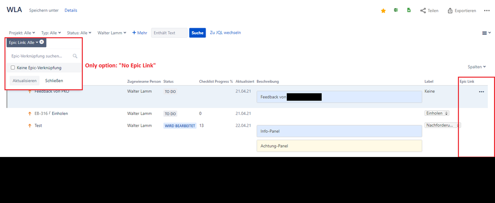

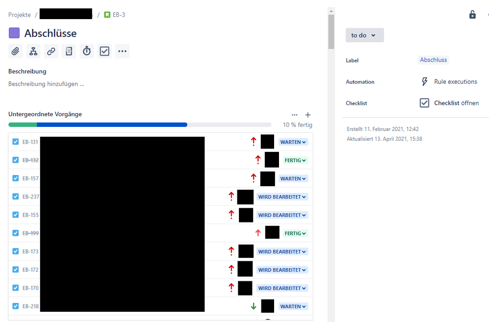

Here is a simple filter which shows I can't even select any other option than "No Epic Link" when filtering for it. The empty column on the right also doesn't return the right epic of which we have two. We use these epics as constant swimlanes to differentiate two major processes. An issue moves through the statuses in the first epic and after a few months through the same statuses in our second epic. So all our issues are part of one of these epics. None of them show up in my filters and don't return any results in my rules though.
Here you can see an example issue with its epic.
Here you can see one of those two epics and all its subsidiary issues.Example Epic.png

Ah, well, I did not know you were using a Team Managed project/board. I am not aware of any way to change the ordering of issues for such a board since the filter for the board is not directly modifiable.
Regarding Epic Link - this appears to be another difference between Company Managed and Team Managed projects. I don't work with Team Managed - I just create them for experiments to try to answer community posts. What I found is that instead of Epic Link, in a Team Managed project the Parent field is used to for identifying the parent Epic for an issue, and for identifying the parent issue of a sub-task.

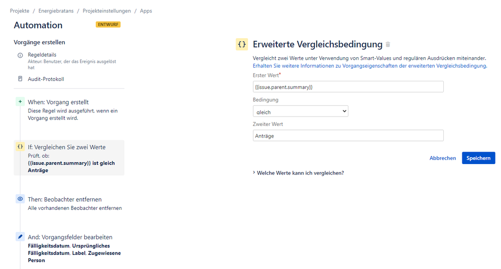

Could you maybe write me the correct smart values I could use when filtering an automation I built?
I want the automation to only work for issues created under the Epic EB-2 which is named "Anträge".
I already tried {{issue.parent.summary}} equals "Anträge":
And also {{issue.parent.key}} equals "EB-2" but unfortunately both didn't work.
I also tried {{issue.parent.fields.labels}} equals "Antrag" (which is EB-2s label) and also the same for {{issue.epic.fields.labels}}. Any idea why none of this worked?

Can you explain the scenario for your automation and what you are trying to accomplish, for the image you showed? There may be a way to accomplish it without smart values.

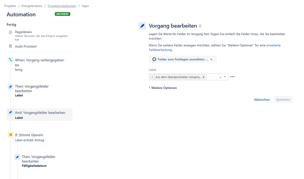

the rule configures the fields for every issue that gets created with some if-clauses which take into account the summary of those issues. For example if the summary includes "XYZ" the estimated time to complete schould be 1h 15m, else 45m and so on.
And that works very well. But unfortunately because we just started to use Jira there are a lot of issues that get created in the second Epic (EB-3 titled "Abschlüsse"), because they were in the second half of our processes when we switched. So the rule configures them as if they were in the first half which is wrong. That's why I wanted to include an if-check for the epic.
And while writing this I remembered I was able to adress the epic with one rule and no others. Here is the rule which gets triggered when an issue is moved to the Finished column. The rule then deletes any labels and in the next step copies the label of the parent issue (übergeordneter Vorgang in German) to the issue which triggered the rule.
I don't understand why this works here and not in other rules. And I don't understand why the next if-check (label = Antrag) doesn't trigger anything after the previous step clearly copied that label into the issue.
