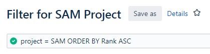

Now if want to create the common backlog for both teams, Let the Original board when you have created the project be the same and follow the first answer I have mentioned.
So you would have three boards on with the filter [project = "" ORDER BY Rank ASC] with no sprints in it, whereas the other two boards would have their respective teams filter in their boards and track their issues !

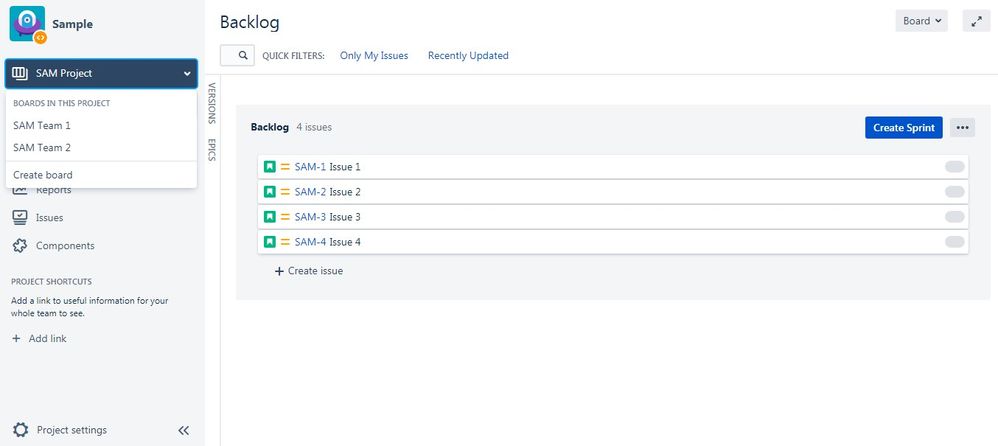

Pramodh M
January 2, 2020
Here is the format of how it looks
This is main backlog
This is filter for Main Backlog

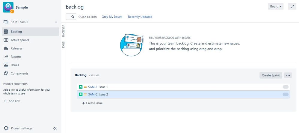

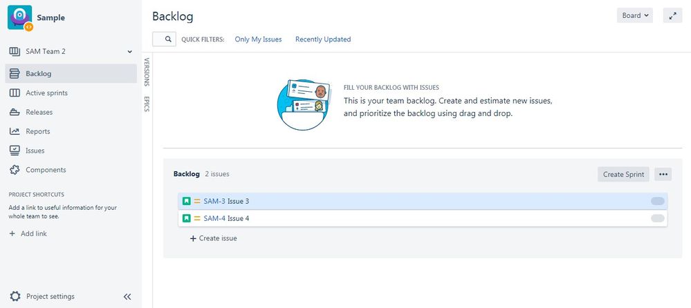

This is Team 1 Backlog, where in you can also track Team 1 Sprints.

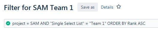

This is Team 1 Filter
This is Team 2 Backlog

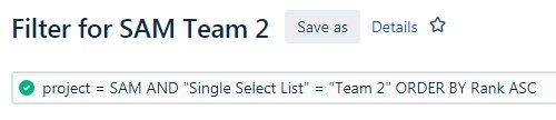

This is Filter for Team 2

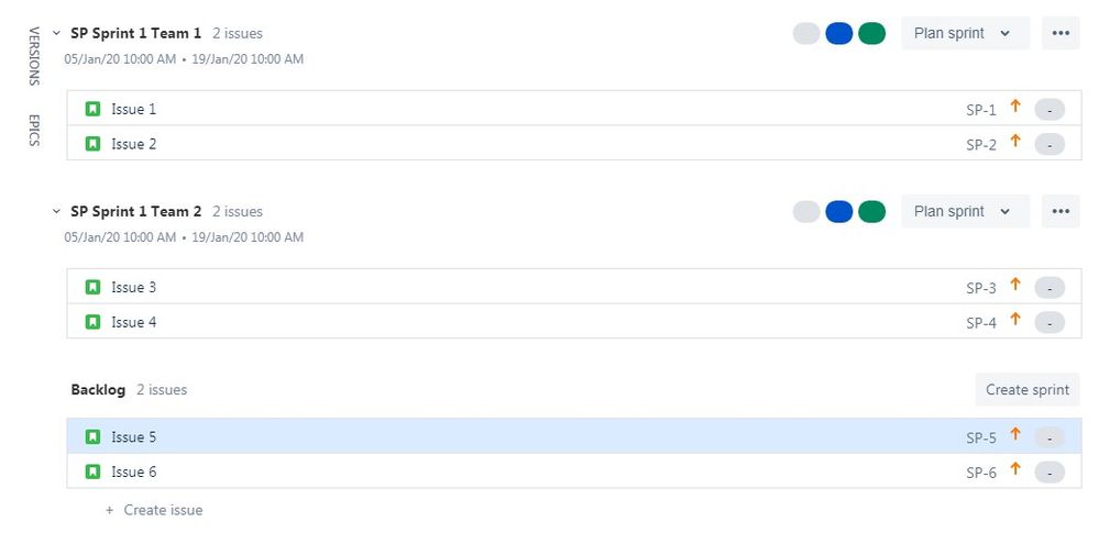

Pramodh M
January 3, 2020
I was using Server for help, then I realized that the question was for next-gen projects.

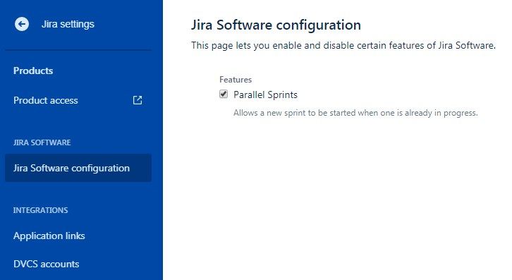

You need to have the parallel sprints to achieve this, follow the link for more info
https://confluence.atlassian.com/jirasoftwarecloud/using-parallel-sprints-797737030.html
Go to Jira settings page in that products page and in that enable parallel sprints
Here is the parallel sprint configured for Team 1 and Team 2

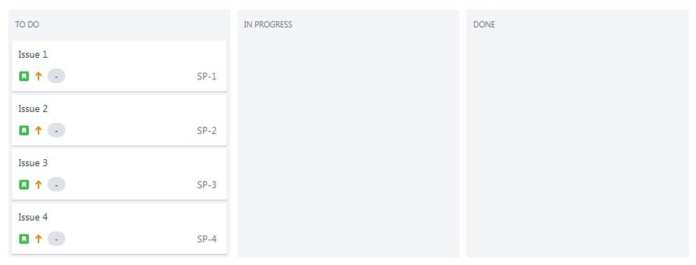

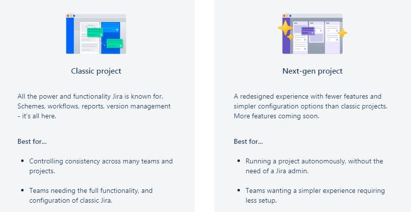

Pramodh M
January 2, 2020

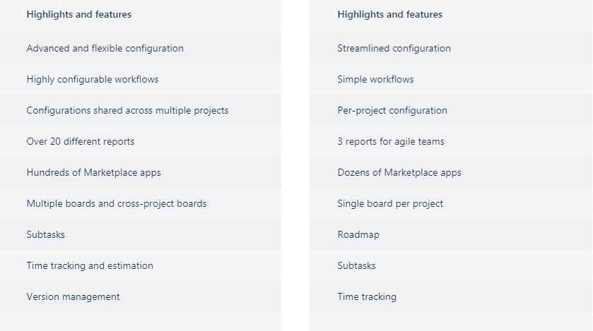

Next-gen Projects are made for small teams with different sets of goals...
Here is the link about Next-gen Projects.
https://confluence.atlassian.com/jirasoftwarecloud/working-with-next-gen-software-projects-945104895.html
There are so many limitations in Next-gen Projects for bigger teams.
Hope this helps !
