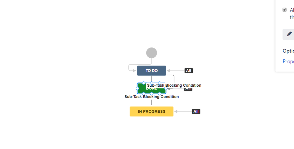

Petterson, still no luck ( I've left the blocking condition for Done but, per your guidance also added to In Progress (gate).  I can remove from Done but even with the new transition, I'm still able to close Stories with open sub-tasks:
Also, please see the screen-shot of the diagram as the problem may be inherent to the (default) flow for this schema...
Petter Gonçalves
April 16, 2019
Hello Bill,
Thank you for the screenshot.
Could you please confirm if the transition all -> Done also have the Blocking condition? As mentioned before, you will need to configure the condition on all transitions that go to Done to make sure it will be applied.

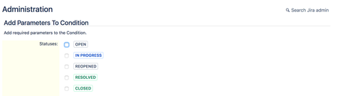

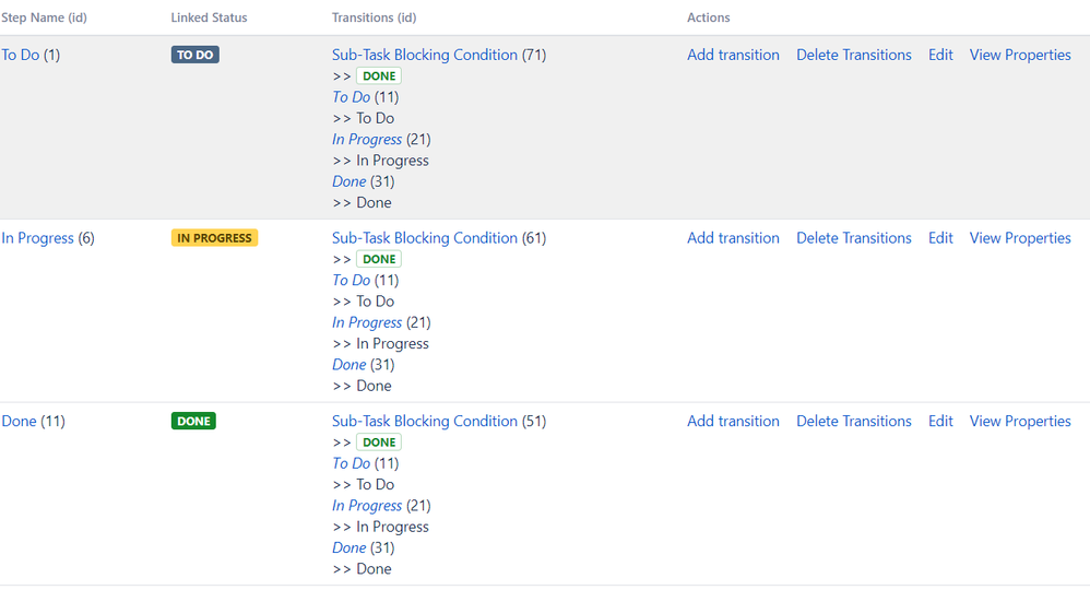

Petterson, I'm not sure how to get to the "Add Parameters to Condition" function, but I've attached another shot showing all transitions.Workflow.PNG

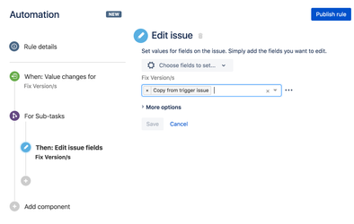

2 - I'm afraid JIRA does not have a functionality to add a version to all sub-tasks when a parent issue is added with it.
The only way to add a version to all sub-tasks when editing the parent issue would be by using a plugin like Automation for JIRA, where you can create a simple rule like the one below:
The mentioned plugin above have 300 free executions per month, so you will not have any costs if you add less than 300 issues with a version.
Let me know if this information helps.
