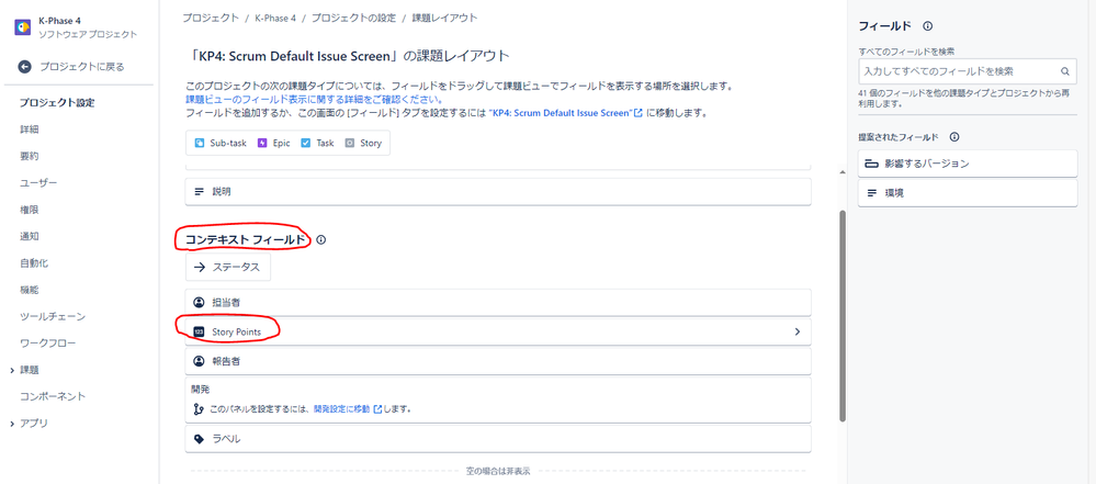

I still have an issue.
Even though, I set a story points in a context field, I cannot see a story points fields when I look at each sub-task...
Bill Sheboy
October 18, 2023
I believe that is the normal behavior, as story points generally apply to a story (which is a valuable, releasable item) versus sub-tasks (which are a piece of a story and usually are not individually releasable).
Although it is possible to make the field accessible for any issue type.
If you scroll down in the issue details on the right side of the page, can you see the field?
YUKI HAMAJIMA
October 18, 2023
@Bill Sheboy
I totally understand that.
However, my team members require the same function that we used to have,
because story points can be more reliable.
I cannot see Story Points altough I scroll down...
Bill Sheboy
October 18, 2023
If you are using a company-managed project, were able to see / add the field to the view, and select that field in configuration, what options are available?
If you see no additional options (such as "Go to field configuration") please check with your Jira Site Admin to further configure the fields.
YUKI HAMAJIMA
October 18, 2023
@Bill Sheboy
I will check with Admin. Thank you very much for your help.
