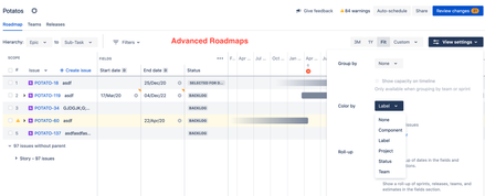

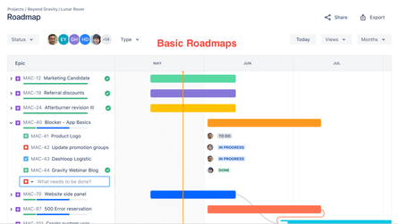

Petter Gonçalves
September 7, 2020
Hello @アレン
Thank you for reaching out.
Per your description, I understand that you are looking for a Gantt Chart that could display its colors based on the issue of progress (Start and End date).
An option that provides you with this functionality would be the Basic and Advanced Roadmaps feature provided with the acquisition of Jira Standard or Premium plan, respectively.
Jira Basic Roadmaps provide you with a basic set of colors, that gives you a limited vision of your issues start and end dates in the chart, while Advanced roadmaps allow you to configure the chart bar colors by labels that you can automatically set using Jira automation based on the issue start and end dates, achieving the exact scenario that you need:
Screen Shot 2020-09-07 at 17.12.30.pngScreen Shot 2020-09-07 at 17.31.09.png
Can you please confirm if one of the options above provides you with the feature you need and if you need further instructions to achieve the scenario mentioned above?
Also, If you are looking for other options using third-party apps, please let us know.
