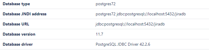

We have Jira Server version 8.13.0.
I need to put the views in a separate schema (not public) and provide the USAGE for that schema to the new user.
Сan I create new schemas in the Jira database?
Can problems and errors occur if I create another schema in the database of Jira?

In the world of databases, the word "schema" is a little bit overloaded.
If by "schema in database", you mean "another database named differently running in the same service", then yes, it's absolutely fine.  In fact, it's very common to see people using the Atlassian stack with one database service running for multiple applications.
So you have stuff like:
  • jdbc:postgresql://mydatabaseserver:5432/jiradb
  • jdbc:postgresql://mydatabaseserver:5432/confdb
  • jdbc:postgresql://mydatabaseserver:5432/bbdb
However, if you are asking about creating things inside the Jira database - no, do not do that.
