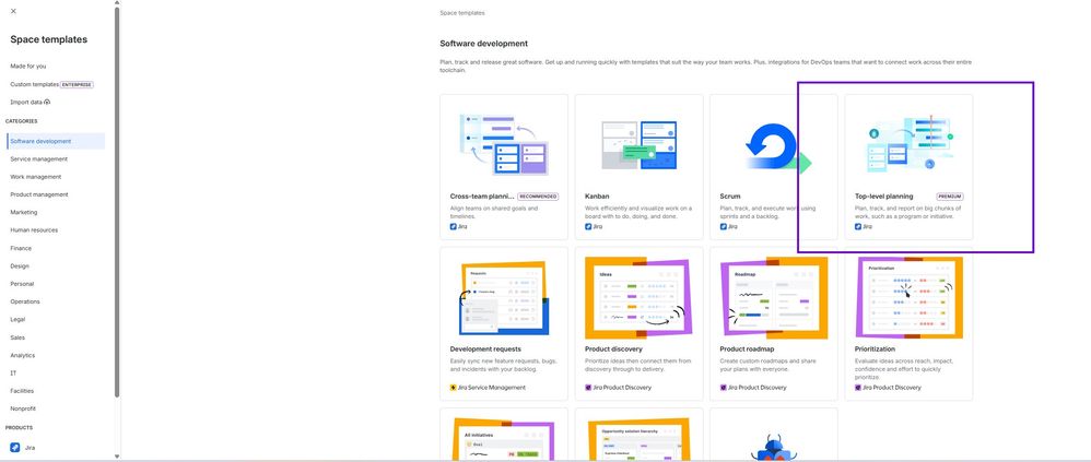

If you’d rather just explore it yourself, here’s how to find this new feature in Jira Software Premium:
  1. From anywhere in Jira Software, select Projects > Create project from the top menu.
  2. In the Software development tab on the left (which is the default tab), select the Top-level planning template.

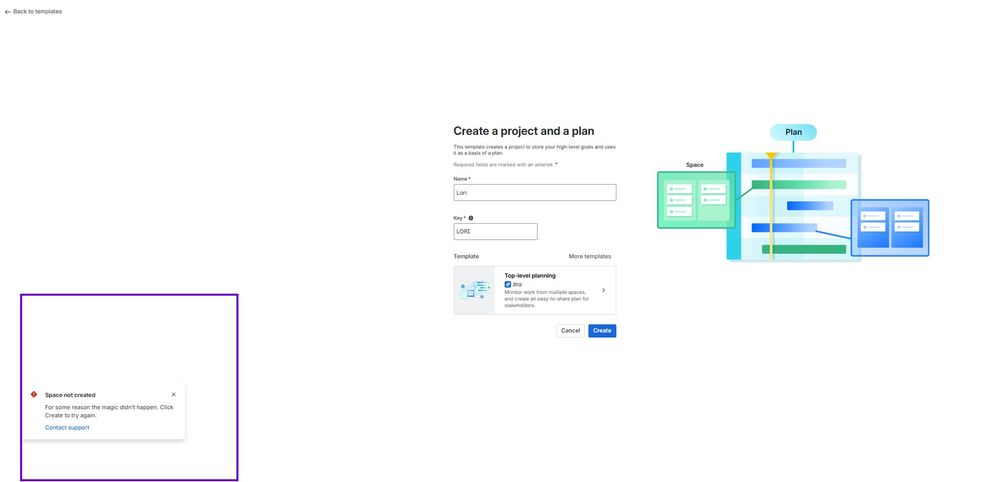

I am trying to create a demo for this new feature, since yesterday, and I am getting an error, in my production and sandbox instances. Is this fully rolled-out?
Like Cricket Williams likes this
Roi Fine
July 27, 2023
Hey @Sérgio Nogueira I'm sorry to hear you've got an error message. We're investigating these errors. One reason this could happen is if you already have an issue type called initiative on your site. Please check if that's the reason, if so I would recommend you change the existing initiative issue type to a different name.
Please let me know if it works for you

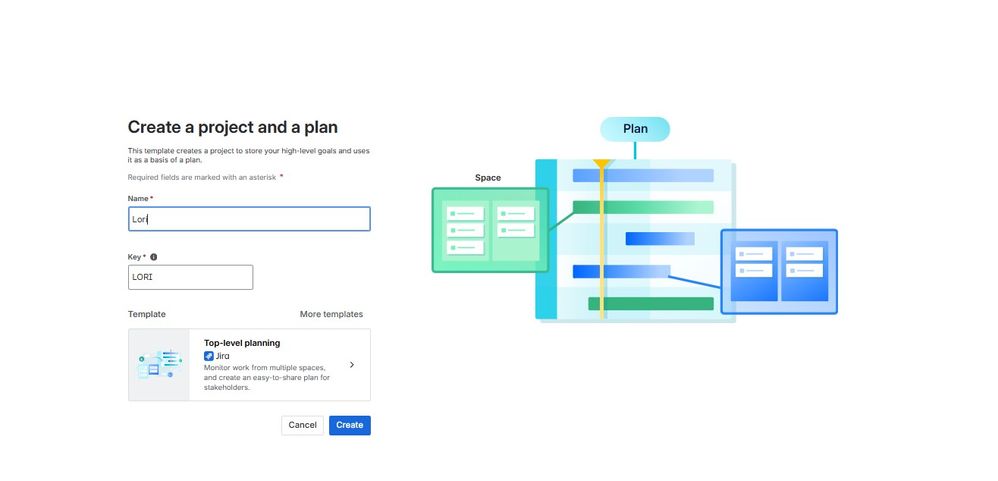

I have the same issue as Sergio.  I have checked and removed the issue type "initiative" but still get the same error, further investigation has discovered that the creation process is creating the Issuetype Initiative, and workflow scheme. But I still receive the error, no project or plan is created
Jason Waller
July 31, 2023
Ok so I worked out the problem...
I had odyssey set at the top of my hierarchy from when I tested ARM last year.  So when the template was trying to set Initiative above the epic is was causing the creation to fail.
Worth checking your Issue Type Hierarchy if you have the problem

Hi @Roi Fine I think that's the issue, we had just setup a process of Initiative Lifecyle and created the issue type Initiative. We are changing it's name, and I'll let you know later if this solved the error. Thanks.
Roi Fine
July 31, 2023
Hey @Jason Waller and @Sérgio Nogueira please let me know if your issue is resolved once you've changed the pre-existing issue type name to something else than Initiative. Otherwise, I'd advice you to contact support so the developers on my team can assist further.
Jason Waller
July 31, 2023
@Roi Fine  it wasn’t having an issue type called initiative that was causing the error for me. The cause was  I already had a hierarchy above epic. In my case odyssey. Once I removed this and epic was the top level in the hierarchy the creation process worked fine
