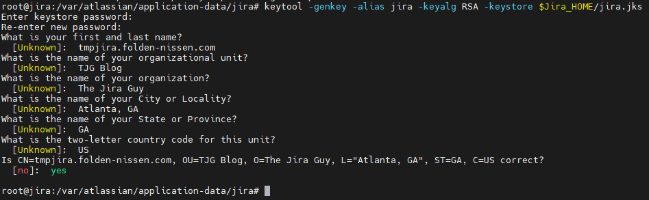

Setting Up the Keystore
The first thing we need to do is set up the Keystore. We can do this with the following command:
$JAVA_HOME/keytool -genkey -alias jira -keyalg RSA -keystore $Jira_HOME/jira.jks
You should note that your keytool may not be found at $JAVA_HOME - mine was found in the bin folder, meaning I could forget the "$JAVA_HOME/" part and just type keytool (see below).
First, it will ask for a password, then repeat it to try to catch typos. It will then ask for your name. Instead of your First and last name, enter the URL for the system minus the protocol (https://). Enter the rest of the info as you see fit. For example, here's mine.

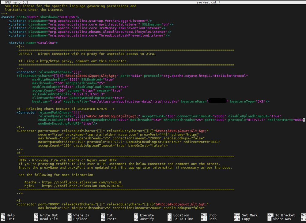

Then we'll open up server.xml with the text editor of our choice. Once inside, we'll add the following block at the same level as the existing connector:
<Connector relaxedPathChars="[]|"
relaxedQueryChars="[]|{}^&#x5c;&#x60;&quot;&lt;&gt;" port="8443" protocol="org.apache.coyote.http11.Http11NioProtocol"
              maxHttpHeaderSize="8192" SSLEnabled="true"
              maxThreads="150" minSpareThreads="25"
              enableLookups="false" disableUploadTimeout="true"
              acceptCount="100" scheme="https" secure="true"
              sslEnabledProtocols="TLSv1.2,TLSv1.3"
              clientAuth="false" useBodyEncodingForURI="true"
              keyAlias="jira" keystoreFile="<Jira_HOME>/jira.jks" keystorePass="changeit" keystoreType="JKS"/>
Be sure to update <Jira_HOME> with your actual home and the keystorePass with your actual keystore password.
We'll then modify the existing connector to serve as a redirect from port 8080 to port 8443.
relaxedQueryChars="[]|{}^&#x5c;&#x60;&quot;&lt;&gt;" acceptCount="100" connectionTimeout="20000" disableUploadTimeout="true" enableLookups="false" maxHttpHeaderSize="8192" maxThreads="150" minSpareThreads="25" port="8080" protocol="HTTP/1.1" redirectPort="8443" useBodyEncodingForURI="true"/>
When you're done, it should look like below:
Save the file and close it. A note here, though. If you are going to be using iptables to forward ports 80 and 443 to 8080 and 8443, you will need to adjust the appropriate ports in your connectors before starting Jira.

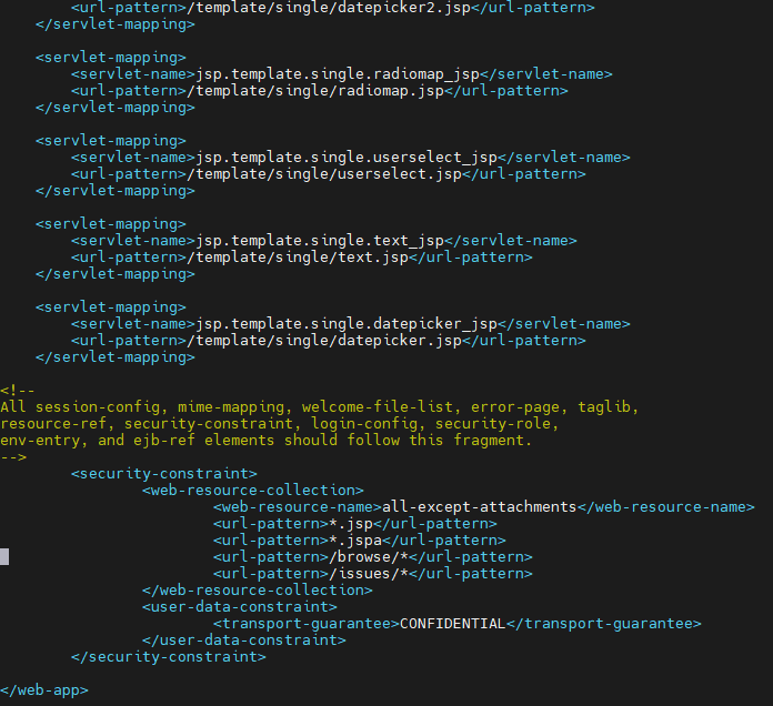

We'll next open $Jira_INSTALL/atlassian-jira/WEB-INF/web.xml. I should note Atlassian's official docs make a mistake here, saying the file should be in $Jira_INSTALL/WEB-INF/web.xml. That is wrong,
cd $Jira_INSTALL/atlassian-jira/WEB-INF/
nano web.xml
This is a rather long file; we are looking for the last line, which should be </web-app>. Right before that tag, we are adding the following.
<security-constraint>
	<web-resource-collection>
		<web-resource-name>all-except-attachments</web-resource-name>
		<url-pattern>*.jsp</url-pattern>
		<url-pattern>*.jspa</url-pattern>
		<url-pattern>/browse/*</url-pattern>
		<url-pattern>/issues/*</url-pattern>
	</web-resource-collection>
	<user-data-constraint>
		<transport-guarantee>CONFIDENTIAL</transport-guarantee>
	</user-data-constraint>
</security-constraint>
Be sure to adjust your tabs as necessary so that everything lines up. It doesn't really matter, it just makes me feel better...

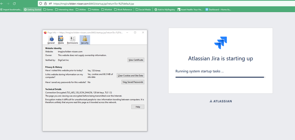

Save this file too, and restart Jira. Once it's up, test it, and make sure it's all working. I missed the leading / on the keystore location in my server.xml file, which I found out by following the $Jira_INSTALL/logs/catalina.out file. But, after that minor correction:
