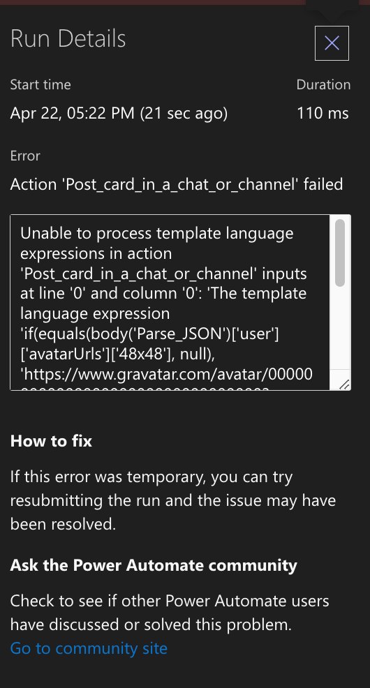

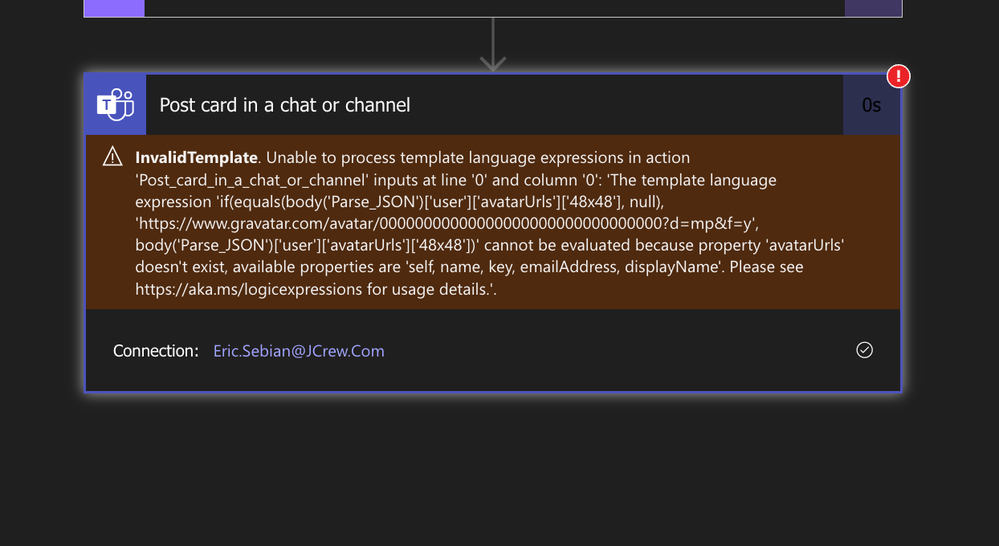

Hi Volodymyr- I have recently upgraded jira to version 10.3.5 and then the links stopped working. it was failing.  Have you heard of anything in version 10 that would create an issue? I have attached some images. it says that the Template is invalid.
Screenshot 2025-04-22 at 5.23.45 PM.pngScreenshot 2025-04-22 at 5.23.13 PM.pngThanks!
Eric Sebian
April 22, 2025
Here is the full error:
Action 'Post_card_in_a_chat_or_channel' failed.
The workflow was working up until the day that I made the change. The full error is:

Hi. you mentioned "please update the adaptive card schema by one mentioned in this article (updated card)." where is the new adaptive card schema mentioned?
thanks.
Like 원유준 likes this
Volodymyr Batrukh
April 24, 2025
Hi @Eric Sebian
I have tested workflows on Jira DC 10.6.0 and no issues found. The card was sent to the channel without any issues.
The updated card can be found on the first page (it was updated) or from this document.
Please try to recreate workflow using updated schemas.
Regards,
Volodymyr B.

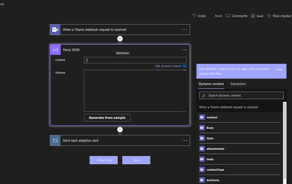

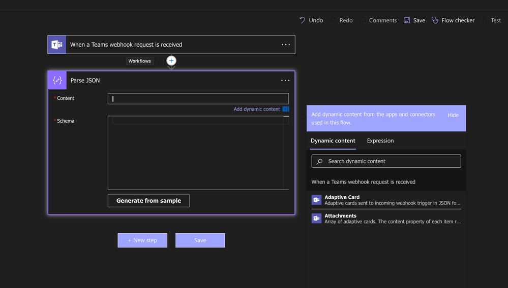

Eric Sebian
April 24, 2025
Hi Volodymyr. After deleting the old entry and starting again. Though I still had issues. For one, when I try to create a workflow from blank now, it doesn't display all of the Dynamic content.
So I had to create a workflow from the template. then it showed.
Screenshot 2025-04-24 at 2.38.11 PM.pngScreenshot 2025-04-24 at 2.33.37 PM.png
I notice now that it working again from the template, I have this empty --> empty. Any idea what that's from?
