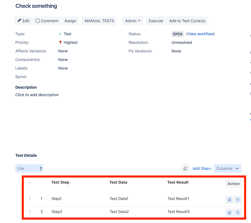

Test step is an entity of a test case. There are can be multiple test steps for a test case. You can see how it looks like in Zephyr in the screenshot below:
Screenshot 2019-01-20 at 22.22.06.pngThen question is:
How to migrate all test steps after we restored a Jira backup?
