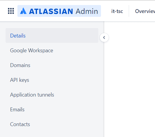

paulcreedy
October 3, 2022
I'm the administrator for the org, as I set it up, and it shows ORG ADMIN next to my username in the users list, but I don't have an option to add an additional administrator.
The options I have on that screen are:

Hana Kučerová
October 3, 2022
@paulcreedy The reason you don't see the menu item is the user management has been changed recently. It should be available under Directory > Users > User detail > Three dots menu > Assign organisation role

Fabricio
January 16, 2026
I think the article is outdated. In the current interface:
  • Go to https://admin.atlassian.com
  • Select the organization you wish to manage (if you have more than one)
  • In the new side nav : Directory > Users
  • Select the user in the list (click on it to user details)
  • In the user details select the three dots menu [...] in the upper right
  • There you have the options to add or remove the admin org role
You can check the active org admin users filtering by this role in the users list Directory > Users.
(https://admin.atlassian.com/o/{your org ID}/users?role=ORG_ADMIN)
