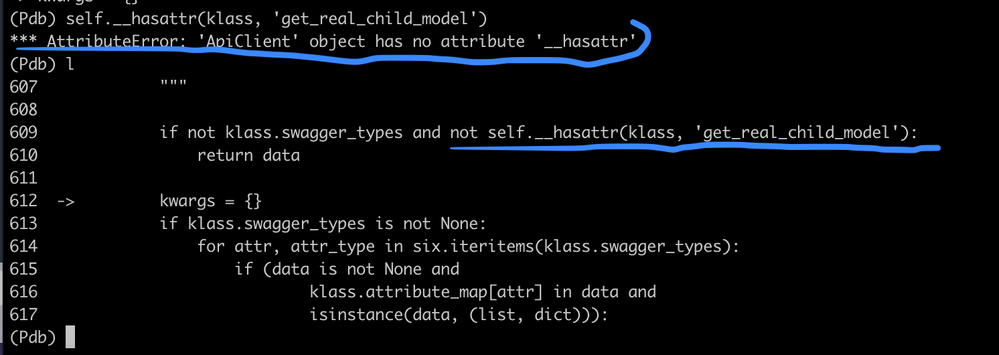

Another thing I noticed is that self.__hasattr() is not defined (screenshot below).Screen Shot 2021-09-14 at 3.32.04 PM.png
Ben Kelley
September 15, 2021
Hmm __hasattr is part of the library code that swagger-codegen writes for you. It should be near the bottom of api_client.py.
