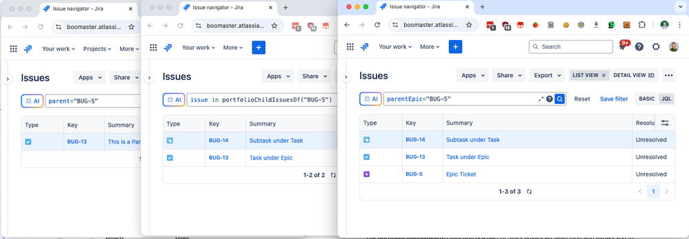

Anyways, this is probably best explained in a picture:
So the hierarchy is like this:
  • BUG-5 is an Epic
    • BUG-13 is a Task under the BUG-5 Epic
      • BUG-14 is a Sub-task under the BUG-13 Task
What I found interesting is what these different JQL functions/fields return:
parent
parent="BUG-5"
Pretty straight-forward. Show me all tickets whose immediate parent is BUG-5.
portfolioChildIssuesOf
issue in portfolioChildIssuesOf("BUG-5")
So, this one shows you ALL the descendants of BUG-5, so Tasks and Subtasks, or children and grandchildren, if we're continuing this analogy.
I guess this could be useful if you really want to find EVERY issue under an Epic. But what's interesting to me is that while portfolioChildIssuesOf is only mentioned on this page about searching custom fields from Plans, which is a Jira Premium feature, it works for me on a Jira Free plan. (Shhh, don't tell anybody - maybe they'll put it behind a paywall.)
parentEpic
parentEpic="BUG-5"
So this is the weird one that does not match the documentation which says:
Search for issues and sub-tasks that are linked to an epic.
I mean, yes, it does return issues and sub-tasks, just like portfolioChildIssuesOf, but interestingly, it ALSO returns the Epic itself!
Could this be useful? I mean, sure? To somebody? I'd love to hear your use cases.
(NOTE: I only tested this on Jira Cloud, and as noted, it's a Free instance.)

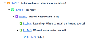

If you have a hierarchy like this:
  • Initiative
    • project
      • Epic
        • Story/Tasks/etc
          • Sub-taks
And you run parentEpic on the Epic level you get the Epic, stories (etc) & sub-tasks.
Do you run in on a Story, you also get the subtasks.
But do you run in on a level above epic, you only get that issue
parentEpic
JQL: parentEpic=PLUM-2
JQL: parentEpic=PLUM-5
JQL: parentEpic=PLAN-4

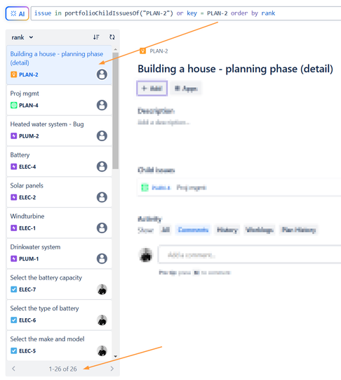

JQL: issue in portfolioChildIssuesOf("PLAN-2") or key = PLAN-2 order by rank
