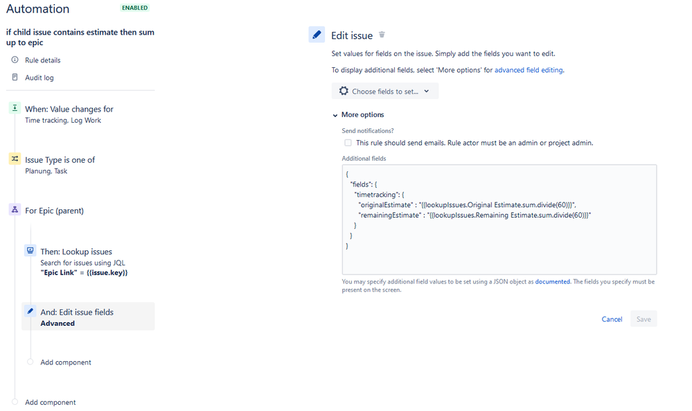

Recently I faced the problem of finding a way to sum up the original estimate of all issue types of an epic, without the use of an addon. I was going to use only the native automation that Jira provides. At first my manager gave me a hint of this example to follow and I thought that "hey! I could use this to solve my problem in no time!".
How little did I know :D
This example worked perfectly when you had stories and subtasks and you wanted to sum up story point. However my problem was a bit different. I had 4 different issue types (standard tasks) from which I wanted to sum up all original estimates and not story points. Long story short, after trying numerous ways and quite a few community proposed solutions, which in my case they didn't work, I came up with a kinda good workaround.
Rule
Below you will find my rule, which after testing it, it works like a charm:

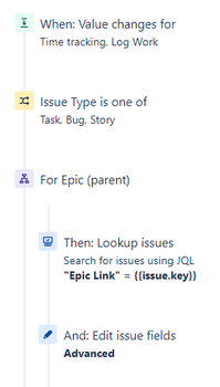

So what the above rule does is that
  • Step 1: It tracks changes on Time Tracking and log work
  • Step 2: Rule keeps going only if the trigger issue type is specific
  • Step 3: Create a branch for the parent of these issue types
  • Step 4: Looks up to find all issues with the parent Epic Link
  • Step 5: Sums up the original estimate and remaining estimate of the Epic's children
Rule Break Down
Below you will find each individual rule component.

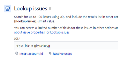

Step 4
"Epic Link" = {{issue.key}}

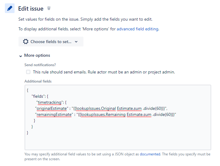

Step 5
"fields": {
"timetracking": {
"originalEstimate" : "{{lookupIssues.Original Estimate.sum .divide(60)}}",
"remainingEstimate" : "{{lookupIssues.Remaining Estimate.sum .divide(60)}}"
Ending Note
I though to end this discussion by presenting to you the pros and cons of this rule, as well as my justification in creating and following it.
Pros
  • It delivers and works!
Cons
  • This rule takes 3 to 3,2 seconds in duration (which I think is significant)
  • It will not perform any calculation if you edit the Epic Link of the standard issue types, or if you delete an Epic's issue
I would very much like to discuss about this solution, and if you have anything better to suggest please do share!
Cheers,
Alex

Bill Sheboy
April 9, 2021
Thanks for the write-up, @Alex Koxaras -Relational- Great work improvising!
Here is my suggestion to add more fields to Lookup Issues access, however it seems to have moved to the dust bin of "future consideration":
https://jira.atlassian.com/browse/JRACLOUD-75018
And, here is a suggestion to make Created Variables editable, which would have also eliminated the need to use Story Points as a working variable:
https://jira.atlassian.com/browse/JRACLOUD-75019
I wonder if there is another field to use...
  • as Atlassian decided to create a new field of Story Point Estimate for next-gen, and
  • apparently you can set either that field or Story Points for an issue, and
  • both are available from Lookup Issues, so
  • Could you use the one you don't need for the working variable rather than walking on Story Points?  Then your built-in Story Point reports can still work.
Best regards,
Bill
Like # people like this
April 10, 2021
Hi @Bill Sheboy!
Thank you for your reply, as well as for informing this thread about your suggestions! Too bad that the first one ended up on the "future consideration" drawer.
Concerning your suggestion about using the Story Points estimates, I really don't know if my client will end up using this field.
One workaround would be to:
  • Create a variable (e.g. Temp) at the beginning of the rule
  • Copy the Story Point value on the Temp variable
  • Execute the rule as it is stated above
  • Copy back the value from Temp to the Story Point field
  • voila
However, this could end up increasing the execution time even more. :/

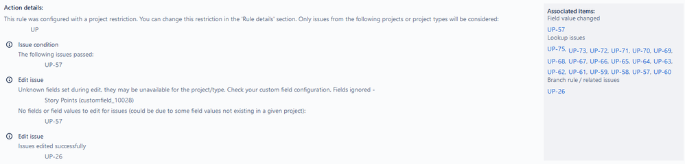

Simon Huprich
February 14, 2022
Hi @Alex Koxaras Hi @Bill Sheboy
I solved it on my own... :-)
I had to activate the Story Point option for my custom issue type

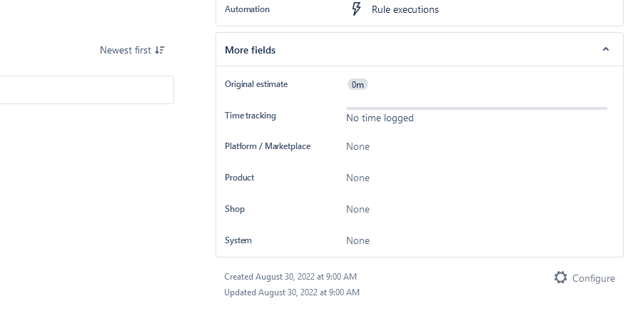

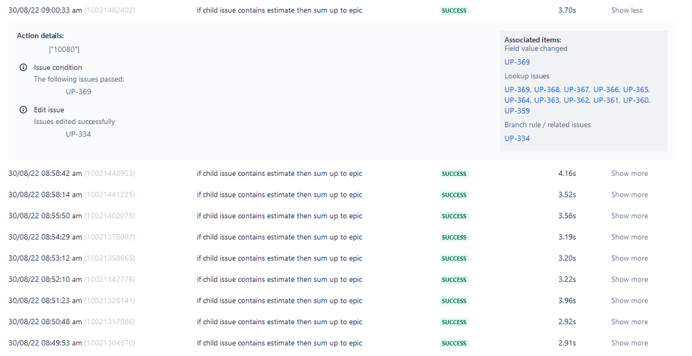

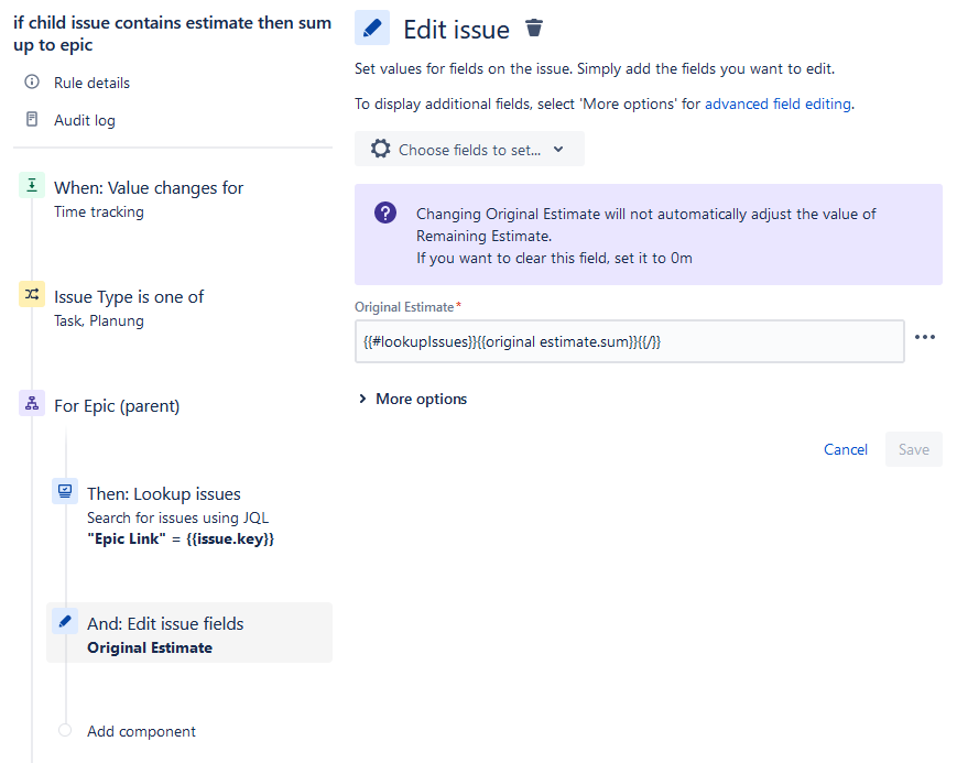

Simon Huprich
August 30, 2022
Hey Alex,
sure...
1. Rules
2. Execution
3. "0m"
Screenshot 2022-08-30 091501.pngScreenshot 2022-08-30 091540.pngScreenshot 2022-08-30 091603.png
Thank you very much!
Greetings
Simon
