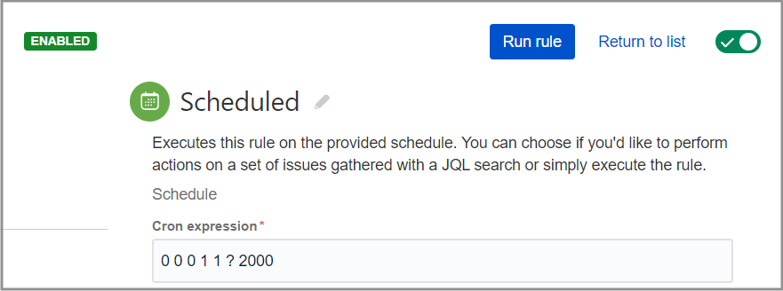

Tip: When developing a new rule, I like to use the Scheduled Trigger (Cloud, Server/DC) and select “Use cron expression” with “0 0 0 1 1 ? 2000” which will never trigger. But the “Run rule” button will work, allowing you to quickly execute the Rule, review the results, and continue working on the Rule.

Pitfall: If your Rule is disabled, even the “Run rule” button won’t work (and no warning or error is shown). Simply enable the Rule to run it.

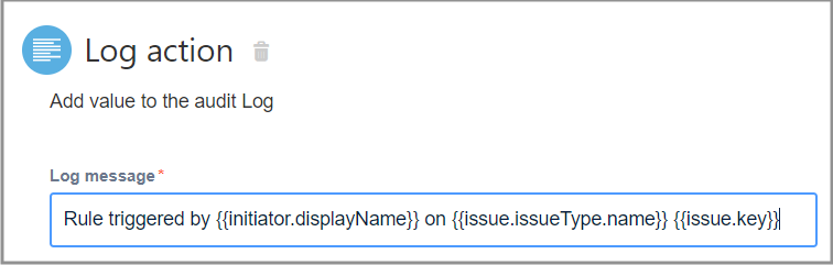

I will often use Log Action right after an issue-based Trigger, to confirm the conditions at the start of the Rule. For example, the following will show the issue and user that triggered the rule:

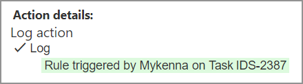

The link to access the Audit Log is on the page where you edit Automation Rules, right under “Rule Details”. Here’s what the above Log Action added to the Audit Log for that rule when it executed:

Much of the power of Automation comes from using Smart Values. The Log Action configuration example above used three Smart Values:
  • initiator.displayName
  • issue.issueType.name
  • issue.key
