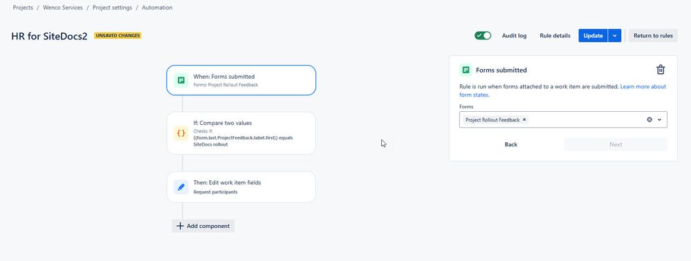

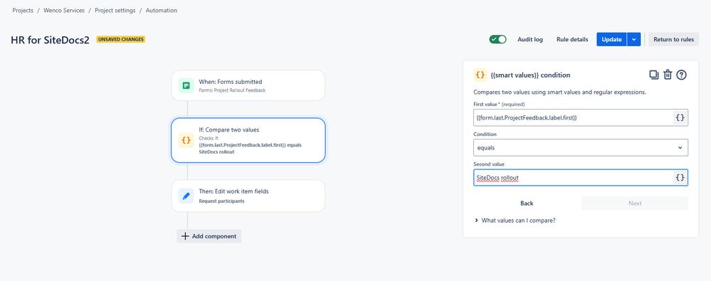

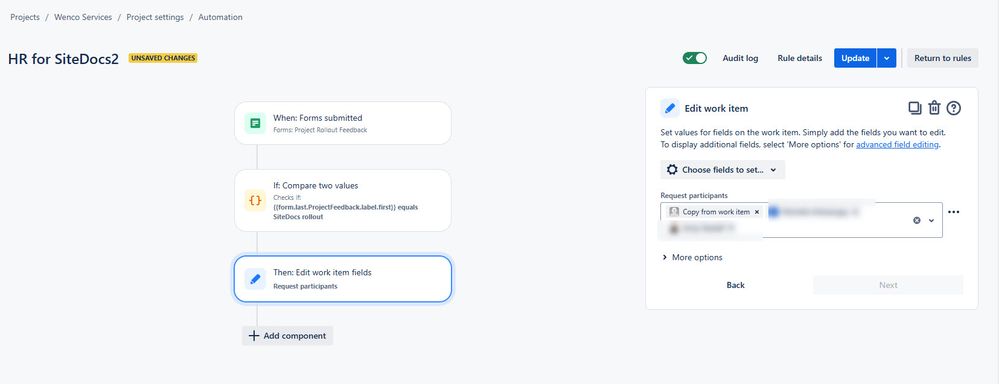

Martina Barnett
June 9, 2025
Hi John
I tried it without the .last option, but that still didn't work.
Please see the screenshots.
cheers
Martina
Martina Barnett
June 9, 2025
2025-06-09_9-52-24.jpg2025-06-09_9-52-35.jpg2025-06-09_9-52-51.jpg2025-06-09_9-57-52.jpg

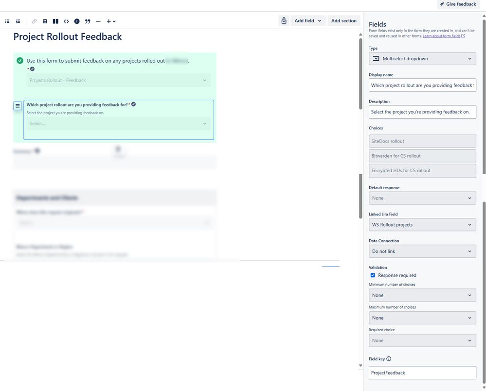

And you are sure the Field key value is exactly ProjectFeedback? Can you share a screenshot of the field details in the form? (If taking out the .first doesn't work :-)
Martina Barnett
June 9, 2025
Ah ok. I'll try that too.
Here's a screenshot of the exact field in the form.
