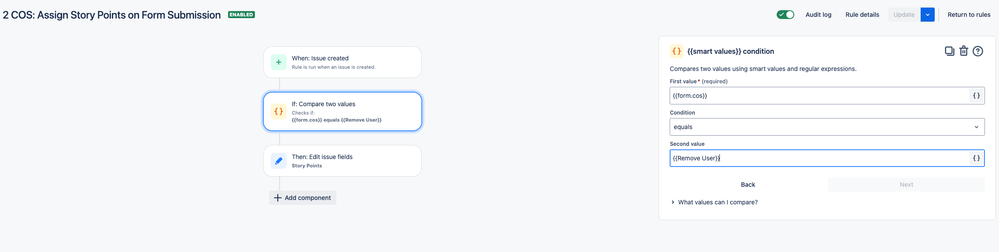

I am working on automating Story Point assignments for issue created via form. The challenge I'm facing involves using form values that aren't directly linked to Jira fields in my automation rules.
I am currently using Field Keys as Smart Values to access these form responses. While the automation recognizes the Smart Value and passes the condition, it's not correctly differentiating between different options within the form field.

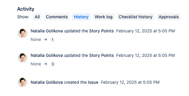

Specifically, I have two separate rules that differ only in the Smart Value condition (representing different form options). The problem is that the automation apllies both rules to the same issue, overwriting the Story Points.
Example
The condition:
First Value: {{form.last.cos}}
Equals
Second Value: {{Add User}}
cos = field key in the form
second value = one of the options from that field
Could you please advice on how to correctly configure the automation rule in this case.

  1. The {{forms}} method only works when using the form submitted trigger - to keep things simple I suggest using this. If that's not an option, we can look into the alternative.
  2. To get the last submitted form, use {{forms.last}}
  3. I would use an If - Else condition, so you can put both into one rule.
  4. In your compare, for first value, you need to get the label of the selected option. This would be {{forms.last.cos.label}}. But wait!
  5. As the output of the dropdown selection is a list, you'd have to go for {{forms.last.cos.label.first}} (assuming there's just one value).
  6. For the second value, you're adding a smart value - this should just be plain text, so simply enter "Add user" (without the quotation marks).
Hope I didn't miss anything in here, but as stated, make sure you add the Log actions when things don't work as intended to figure out what goes wrong (and where).
Good luck!
Best regards,
Bob
Natalia Golikova
February 20, 2025
Thanks! It is working!

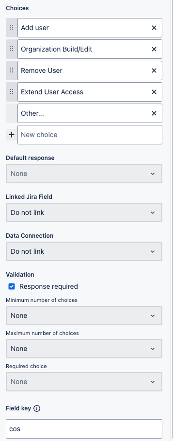

Could you perhaps describe the conditions you're trying to apply?
Also, it would be helpful to add screenshots of the automation rule(s) and the form configuration.

Natalia Golikova
February 12, 2025
Screenshot 2025-02-12 at 4.08.37 PM.pngScreenshot 2025-02-12 at 4.07.28 PM.pngScreenshot 2025-02-12 at 4.07.52 PM.pngScreenshot 2025-02-12 at 4.09.13 PM.png
Natalia Golikova
February 12, 2025
@Bob Dalm Here are the screenshots.
I use
{{smart values}} condition
Compares two values using smart values and regular expressions.
Thanks!!!
